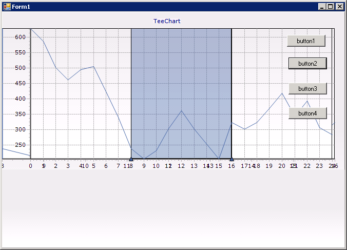

I follow with some problems in the same topic.
Please find an example project to reproduce.
http://193.145.251.126/pnp/files/TnROgF ... leZoom.zip
If you press button1 to configure the chart. Button2 to save the chart, and button 3 to open the save chart the margin in the scrollpager is changed.
And if you reopen the application and press button3 to open the saved chart the margin of the main chart is also changed.

That's because when exporting/importing a chart, associated events are not being exported. The reason behind that is that you could load that chart in an application where those events doesn't exist, which would cause an error loading the chart. Having that in mind, you should add the event handlers again. So you should only modify button3_Click code in your project to look like this:
        private void button3_Click(object sender, EventArgs e)
          chart.Import.Template.Load(@"C:\testzoom.ten");//
          chart.GetAxesChartRect +=chart_GetAxesChartRect;
          Steema.TeeChart.Tools.ScrollPager mt = (Steema.TeeChart.Tools.ScrollPager)chart.Tools[0];
          mt.SubChartTChart.GetAxesChartRect += SubChartTChart_GetAxesChartRect;
          addPagescroller(mt);
