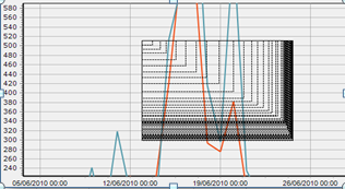

Sometimes I see the efect of the screenshot, and I noticed it is due to FullRepaint. Can I avoid this effect dupplicating/triplicationg... the square when using zoom?

Can you please attach a simple example project we can run "as-is" and let us know the exact steps we should follow to reproduce the problem here? The link in your first post is no longer valid.
acastro
Posts: 204
Re: Scrollpager and zoom
Post by acastro » Wed Jun 25, 2014 1:56 pm
http://193.145.251.126/pnp/files/ZhRPwi ... chart3.zip
Press button1, and then move the mouse with left button clicked to set the zoom
Post by Narcís » Wed Jun 25, 2014 2:59 pm
Hi wakeup,
This is a bug, I'm afraid. Please feel free to add it to bugzilla. Doing so you'll receive automatic notifications on any issue update.
