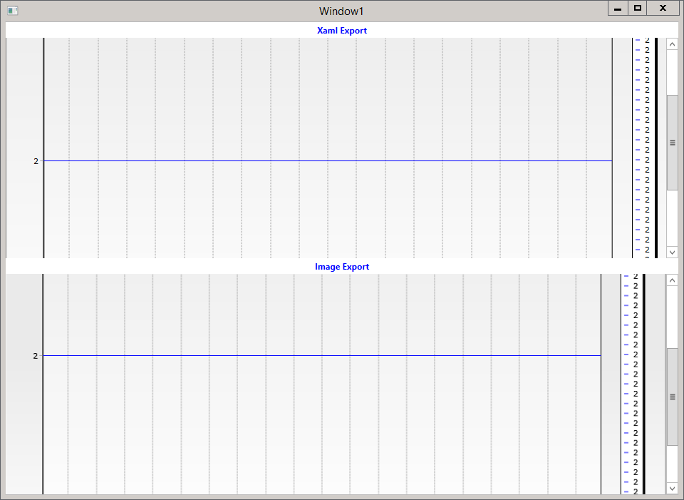

I see the XamlExport.xaml ("Show run time xaml export" button) doesn't show the horizontal green lines. However, I'm not sure to see how you created the file XamlExport.xaml. We'd need to recreate the chart that seems to produce a wrong xaml when exported.
If I create a chart with an horizontal line in your application ("Draw straight Line" button) and then I export that chart to a xaml ("Show Xaml and Image" button), this looks fine for me here:

1. When you run the test project we attached, you will see a tee chart graph showing "steps" shaped graph data (that works perfectly fine).
2. when pressing the "Show Xaml and Image" button on the top left corner of the screen, a new window will open showing the resulted xaml export of the same graph on the top section and the image export result on the bottom section.
3. You can clearly see that in the xaml export result the line on the "steps" shaped graph is cut in multiple places.
Our requirement:
Send us back the project where the graph xaml export works properly (you can use any version of Dll's you want).
By "xaml export that works properly" we mean: that on the "Show Xaml and Image" window that opens after clicking the "Show Xaml and Image" button the xaml export result you see at the top looks identical to the
Image export result you see on the bottom section (without any cuts or missing data on the graph).

I build your project with the latest TeeChart for .NET release (build 4.1.2014.12150-12154) and the exported bitmap and xaml files are absolutely identical, find them attached. Can you please try compiling your project with the latest TeeChart assemblies available?
