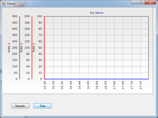

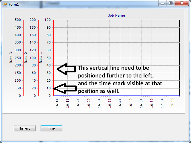

In the 2 images I have posted here, I need to figure out how to make the 1st label and 1st vertical line appear at the leftmost position of the graph regardless of the value.
I have also uploaded the project as well.
This 1st picture shows the discrepancy.
This picture is similar what it should look like - it should have a time mark under the rightmost edge of the graph as well.
Please note that this picture seems to be exactly what I need, however at any given time this is not what it looks like - (see Pic1).
Thanks for your assistance!
