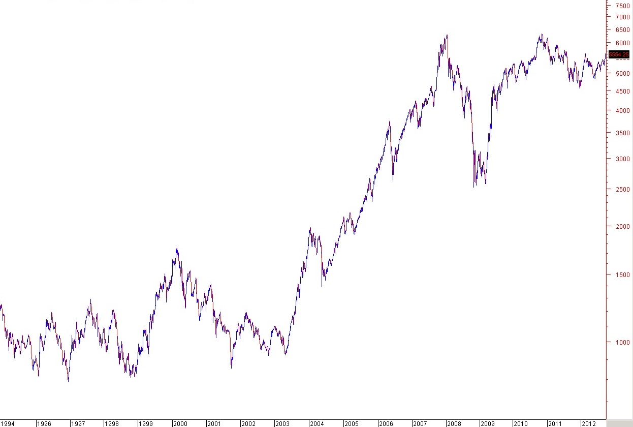

Step 1] Consider a chart (OHLC with Candle Line) with Right Axis Semi Log Scaled as shown in below screenshot (Screen 1).
Screen 1

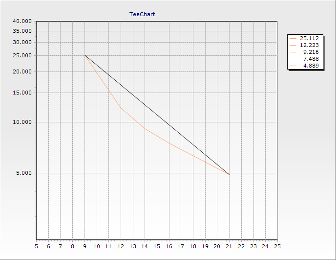

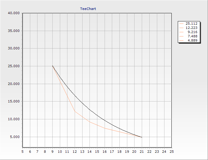

Step 1:
Step 2:
This is just a proof of concept that TeeChart is capable of rendering this change from [straight line in log] -> [curve in non-log] ... the actual implementation of this in your context may be a little different.
