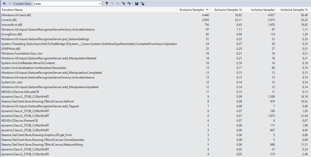

On this machine this gives me peak FPS of about 13, which compares to the FPS of about 64 using similar code under Windows Forms. Looking at the results of a performance profiling session suggests to me that the difference in speed is not due to TeeChart code but is due to the UWP framework itself, e.g.
I think therefore that TeeChart.UWP is not suitable for very high speed plotting. However, if you are happy with FPS of 10 then TeeChart.UWP can easily be used - when adding points to a series in realtime, please be aware that points will accumulate in it which will affect performance. As a countermeasure you can eliminate series points when the series count reaches a certain number.
