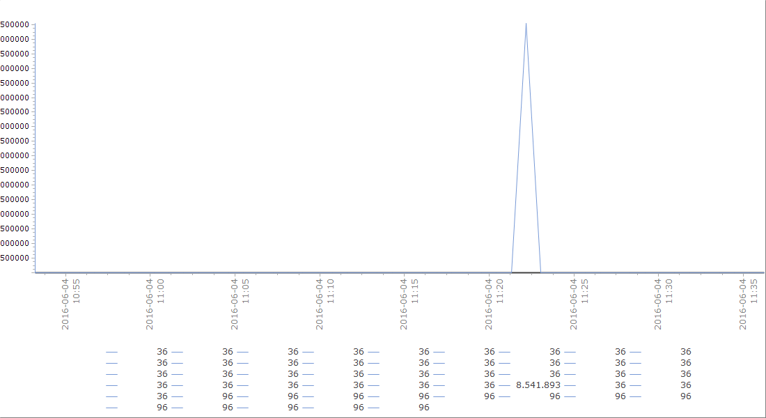

And the result is this:
Is this what you would expect?
Also, I cannot see in this code any attempt to implement the solution you mentioned in your first message in this thread - should I be able to see in this code where you have attempted to implement it?

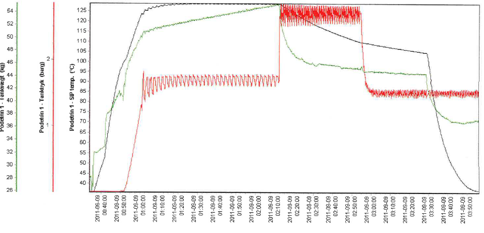

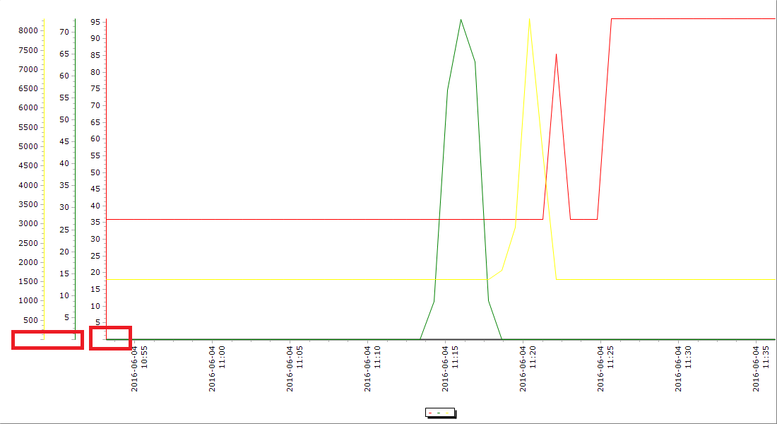

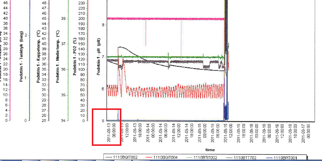

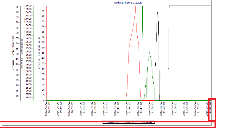

The issue is starting position of X-axis and Y-axis values. I would expect the chart as per attached. Also, the code I tried is in tChart1_AfterDraw method.

I think I've got a couple of solutions for you. Firstly the zero that does not appear on the custom axis - this is due to the custom valueformat, which should be changed to this:
WebChart1.Chart[0].CustomVertAxis.Labels.ValueFormat = "####0;{####0};
and the singular label on the bottom axis was because, for your data, the increment was set too high:
double inc = 1.0 / 480.0; //five minutes
I hope that helps.

Need your inputs on removing the border (bottom line) marked in attached screenshot (Trend_chart1). We need the border to just chart area as attached in screenshot (Trend_chart2)
Re: Bottom and Custom Vertical Axis Label Start Position
Post by Christopher » Wed May 25, 2016 3:21 pm
Priyanka wrote: Thanks. It solved both issues :)
You're welcome, I'm very glad to hear it!
Priyanka wrote: Need your inputs on removing the border (bottom line) marked in attached screenshot (Trend_chart1). We need the border to just chart area as attached in screenshot (Trend_chart2)
You can try:
WebChart1.Chart.Panel.Bevel.Inner = BevelStyles.None;
WebChart1.Chart.Panel.Bevel.Outer = BevelStyles.None;
Post by Priyanka » Thu May 26, 2016 9:10 am
Hi Christopher,
I tried it but no luck.
