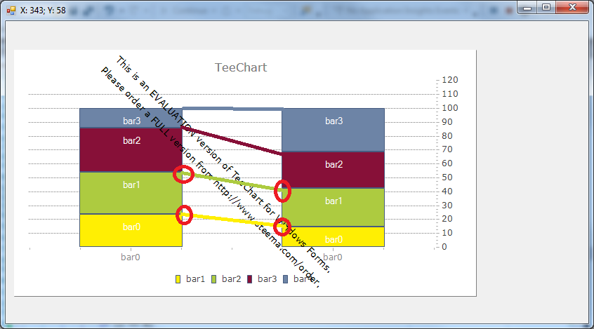

Yes , this part i got it . here in the attached image. Can you please help me to how i should approach the missing part in between stacked graph
Re: Tee Chart .net / ASP.net
Post by Sandra » Tue Aug 09, 2016 9:58 am
Hello rpt,
I have attached for you two applications, one in Teechart.Net c# and the other Teechart.Net in Asp.net where you show how can do your request.

Thanks for your help. I am able to draw 2 bar graph with random values adding upto 100.
What i would like is to draw in between 2 bars . As shown in figure i want to draw line and then fill them with some color
or if possible i can place a another chart and lower the z index ( i am not sure if this is possible)
Can you point me to API reference help or some tutorials

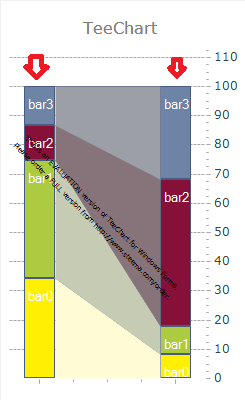

Post by Sandra » Thu Aug 11, 2016 2:23 pm
Hello rpt,
I think can be useful for you, use a SeriesBandTool. Attached you find a simple example shows you how can do that.
TestBarSeries.zip
(10.52 KiB) Downloaded 1046 times

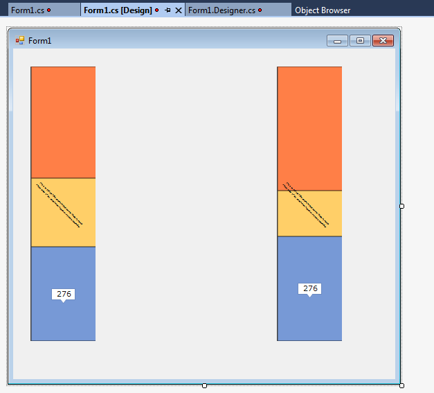

thanks for the help. I could able to get a chart very close . but i am missing labels at top and Also i need to make Y axis ( 0,25,50,75,100)
I did by inheriting Bar class. But doing so my designer is not working. Is there a way to fix it.
Post by Sandra » Fri Aug 12, 2016 8:07 am
Hello rpt,
To fix the problem you're experiencing you need only change the MarkStyle Value. The code below shows you how:
bar.Marks.Style = Steema.TeeChart.Styles.MarksStyles.Value;
Hoping this helps you
Thanks in advance
