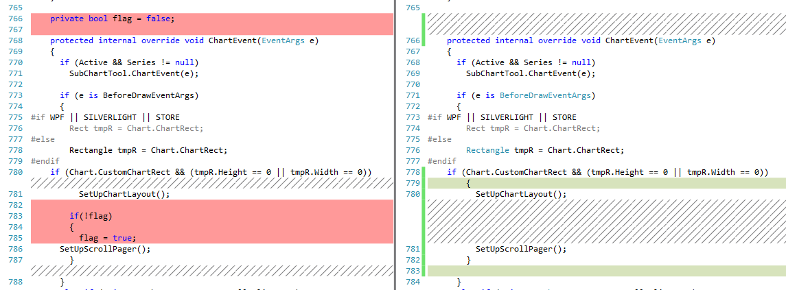

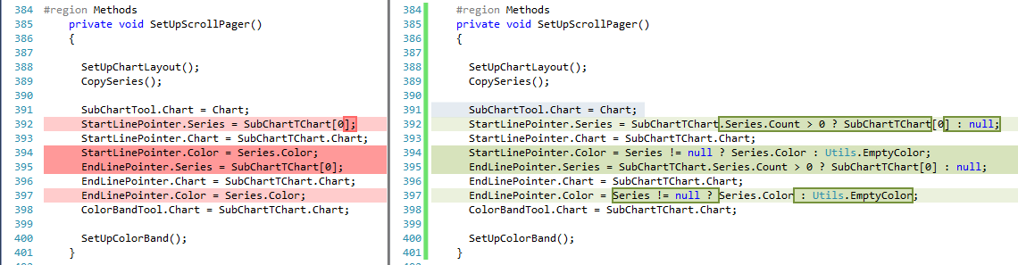

If you have the source code, within the ScrollPager.cs unit you can make these changes:
these should fix the designtime issues for you.
