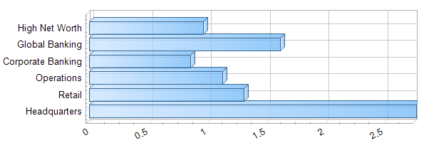

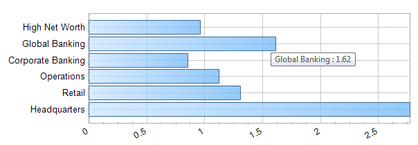

1) For this chart, marks tips work correctly when I hover:
But if I add ANY Z depth (either from our code using the "Z depth tool" or from your [very complex] tools dialog), marks no longer display when I hover. Why is this?

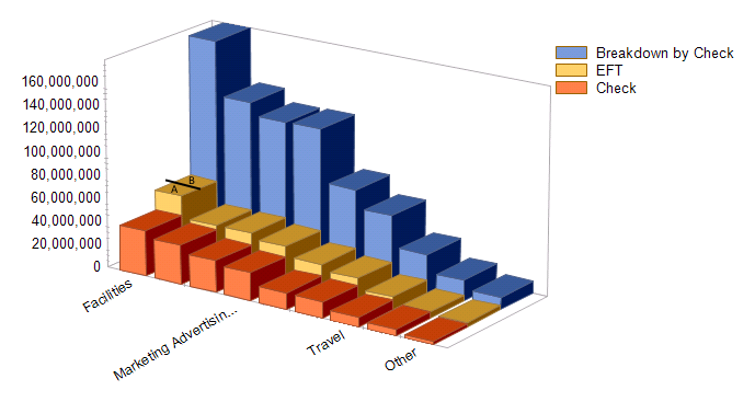

2) For this chart:
When I hover over the area marked "A", I see the correct mark tip with the "EFT" (yellow) series displayed.
But when I hover over the area marked "B", I see the incorrect mark tip with the "Breakdown by Check" (blue) series displayed.
It's like B's Z projection is "hitting" the blue series with no regard for the fact that the projection is passing through the yellow series first.

2) For this chart:
Unfortunately, I can't reproduce the problem you're experiencing here. Could you arrange for us a simple project, where the problem appears because we can reproduce it here?

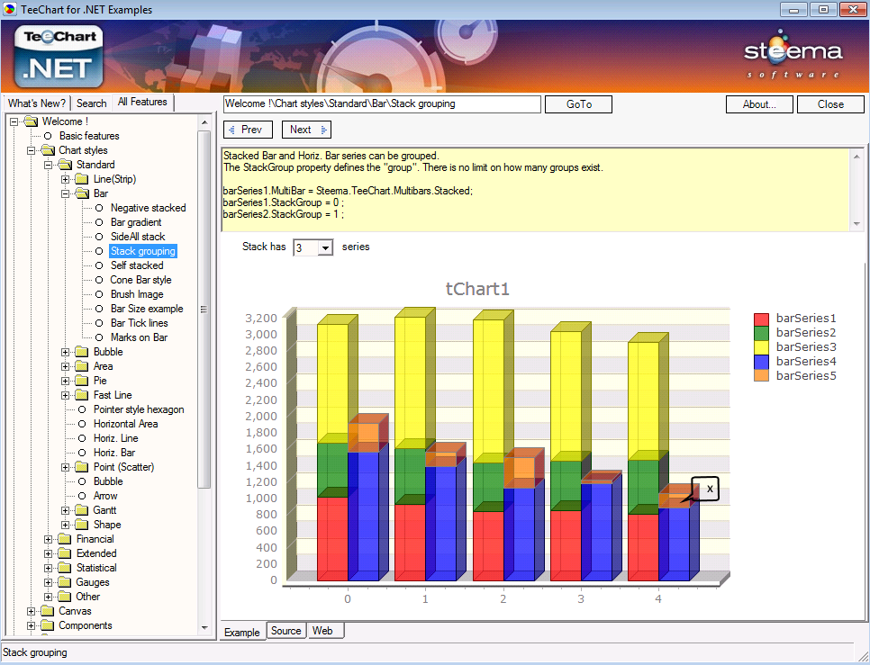

Start the demo and go to the stacked bar demo as shown below:

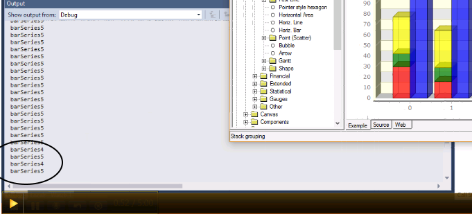

If you position your mouse where the call-out called "x" point, you will see the following text in the output window of the debugger:
barSeries4
barSeries5
barSeries4
barSeries5
barSeries4
barSeries5
barSeries4
As you can see the series is oscillating between both series. Therefore, you are triggering the call back for both series when the mouse is over the "overlap area" without regard for which series is actually on top.
