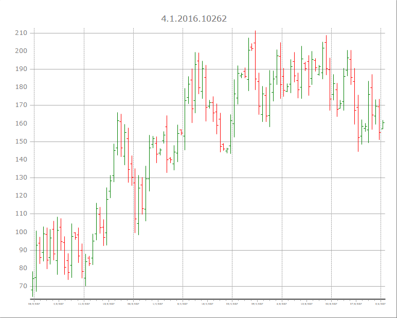

Figure 1: Using the TeeChart theme gives me this screen. A uneven spacing of vertical grid lines. Note that I had to set the ChartAxis.Grid.DrawEvery = 1; in ThemeProperties.ChangeAxis(Axis ChartAxis) for bottom axis because for some reason it is set to 2 and what it does is skip 1 line which is not what we want.
Figure 1

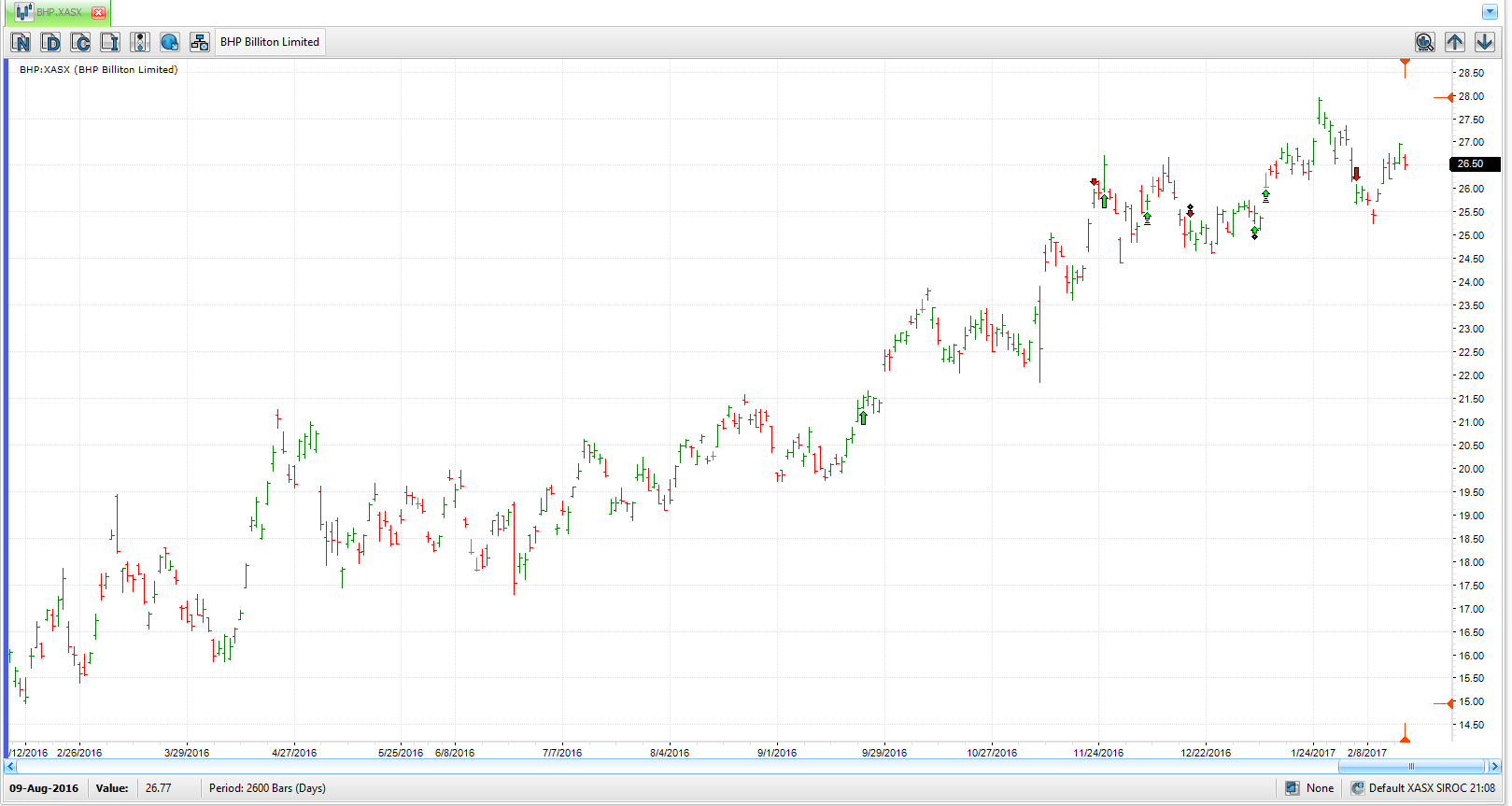

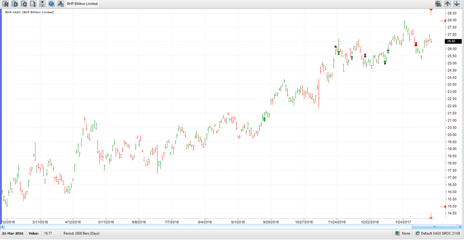

Figure 2: It seems that commenting this code ThemeProperties.Instance.AxisLabelsFontSize = 8; from TeeChartThemes.SetDefaultValues() fixes the problem but the spacing is too wide compared to what we currently have.
Figure 2

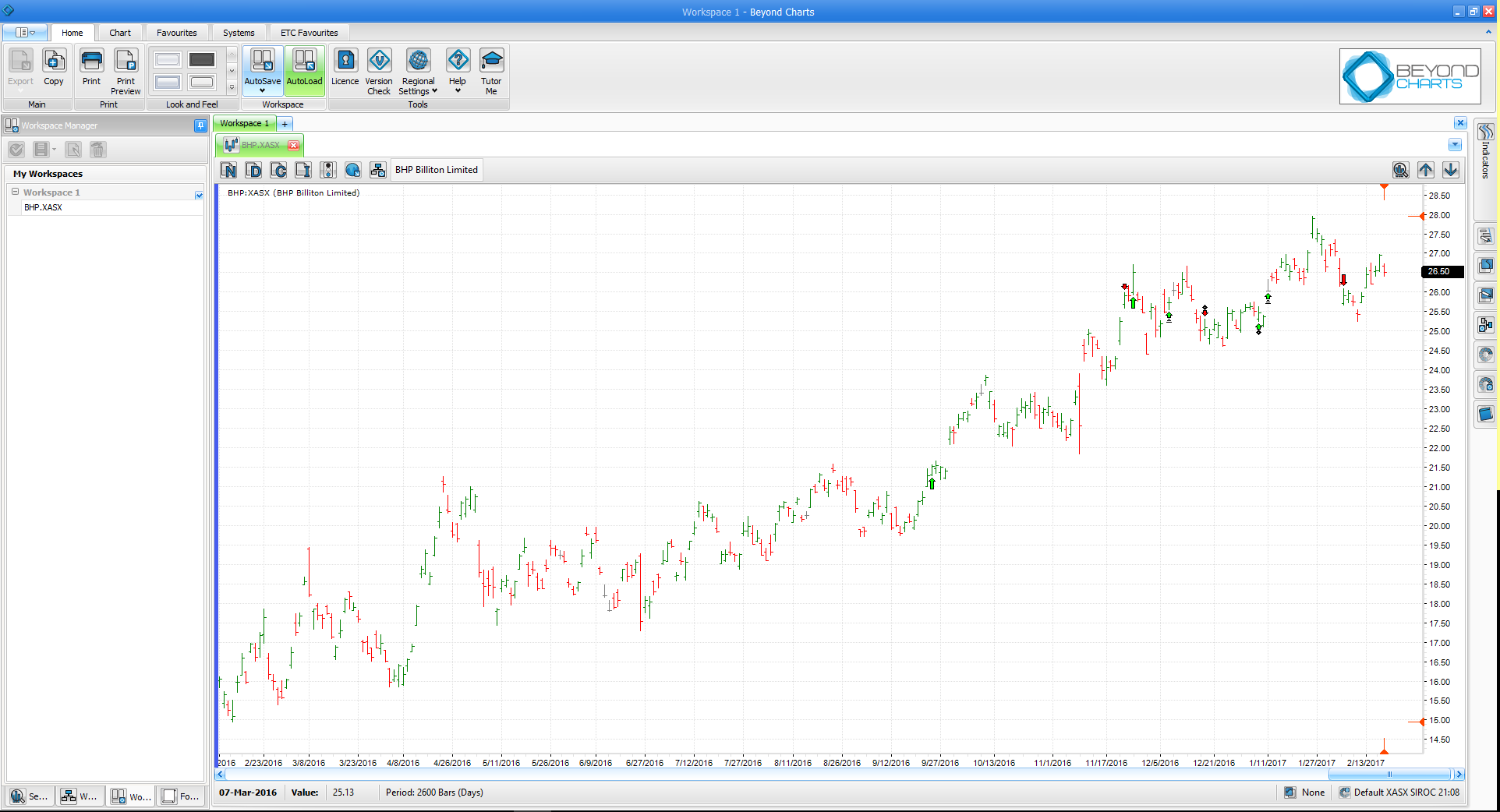

Figure 3: Is what our current app looks like with the old version of TeeChart.
Figure 3

the following code, using the latest publicly available version of TeeChart.dll:
      CreateChart();
      InitializeChart();
    TChart tChart1;
    private void CreateChart()
      tChart1 = new TChart();
      splitContainer1.Panel2.Controls.Add(tChart1);
      Candle series = new Candle(tChart1.Chart);
      series.FillSampleValues(100);
      series.UpCloseColor = Color.Green;
      series.Style = CandleStyles.CandleBar;
      tChart1.Axes.Bottom.Grid.Visible = true;
      tChart1.Axes.Bottom.Labels.Font.Size = 3;
      tChart1.Header.Text = Utils.Version;
      tChart1.Export.Image.PNG.Save(@"D:\FTP\" + "TChart" + DateTime.UtcNow.Ticks.ToString() + ".png");
gives me the following:
do you obtain the same at your end?

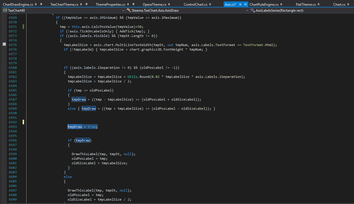

After a digging through the code, I noticed that there is a logic that skips a line when the label is too wide which I think is there to avoid overlapping dates. I found it in Axes.AxisLabelsSeries(Rectangle rect)
where tmpDraw will be false if it thinks the date will overlap. I fixed this to always true and I got the result that I needed except that its a bit cramped..
This is the code where I force tmpDraw = true
Figure 1
And this is what I got
Figure 2
