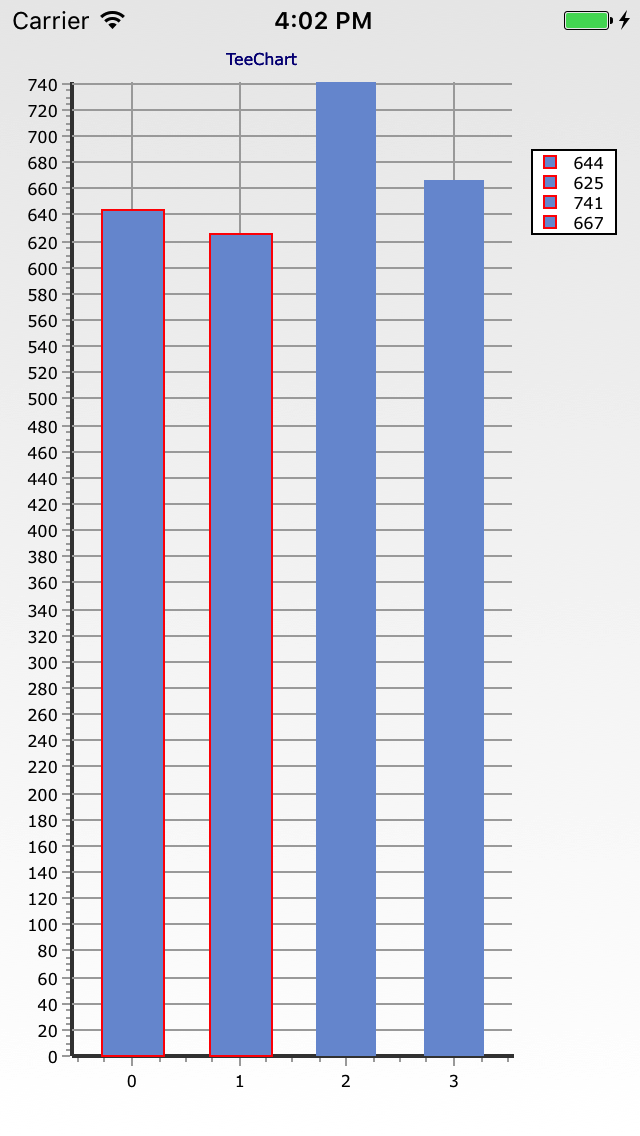

        public override void ViewDidLoad()
            base.ViewDidLoad();
            tChart = new TChart();
            tChart.Frame = this.View.Frame;
            var bar = new Steema.TeeChart.Styles.Bar();
            bar.Marks.Visible = false;
            tChart.Series.Add(bar);
            bar.FillSampleValues(4);
            bar.Pen.Color = Color.Red;
            bar.CustomBarWidth = 30;
            bar.BeforeDrawPoint += Bar_BeforeDrawPoint;
            this.View.AddSubview(tChart);
        private void Bar_BeforeDrawPoint(Series series, BeforeDrawPointEventArgs e)
            if (e.ValueIndex < 2)
                (series as Steema.TeeChart.Styles.Bar).Pen.Visible = true;
                (series as Steema.TeeChart.Styles.Bar).Pen.Visible = false;
I get the following result :
Please, send me an example image, or explain in more detail what're you trying to accomplish.
