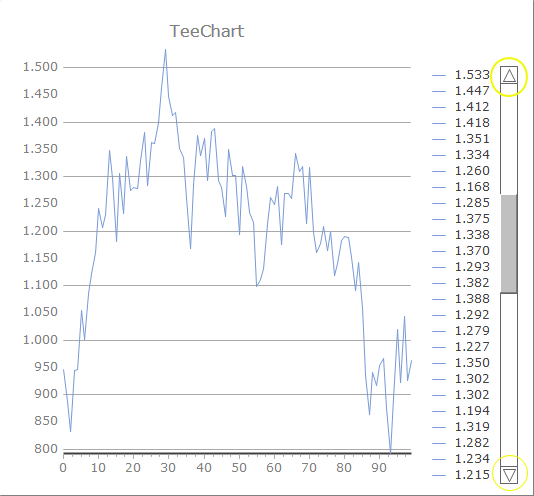

Using the .NET 4.0 version of the TeeChart.dll from the latest version and the following code:
      Line series = new Line(tChart1.Chart);
      series.FillSampleValues(100);
      LegendScrollBar tool = new LegendScrollBar(tChart1.Chart);
I obtain the following:
from what I understand the problematic rendering should occur within the two yellow circles, but in my view the placement of the arrows seem correct, or rather, are symmetrical and non-overlapping.
