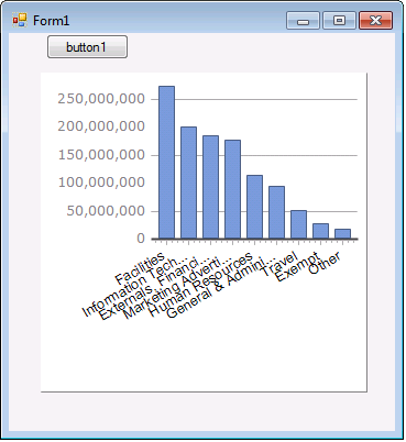

Here is separation of 0:
(problem #1 with descenders and ascenders overlapping)

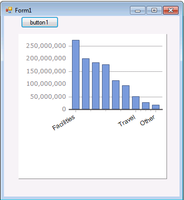

Here is separation of 1:
(problem #2 labels all but disappear when they could have been drawn every other one.)

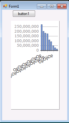

Here is another way to show the problem. Replace the code:
            TheSeries.Add(0, 273423155, "Facilities");
            TheSeries.Add(1, 201478304, "Information Tech...");
            TheSeries.Add(2, 184443667, "Externals, Financi...");
            TheSeries.Add(3, 177618980, "Marketing Adverti...");
            TheSeries.Add(4, 113353935, "Human Resources");
            TheSeries.Add(5, 93689069, "General & Admini...");
            TheSeries.Add(6, 51526793, "Travel");
            TheSeries.Add(7, 28238498, "Exempt");
            TheSeries.Add(8, 16809770, "Other");
With:
            TheSeries.Add(0, 273423155, "OpOpOpOpOpOp");
            TheSeries.Add(1, 201478304, "OpOpOpOpOpOpOpOp...");
            TheSeries.Add(2, 184443667, "OpOpOpOpOpOpOpOp...");
            TheSeries.Add(3, 177618980, "OpOpOpOpOpOpOpOpOp...");
            TheSeries.Add(4, 113353935, "OpOpOpOpOpOpOp");
            TheSeries.Add(5, 93689069, "OpOpOpOpOpOpOpOp...");
            TheSeries.Add(6, 51526793, "OpOpOp");
            TheSeries.Add(7, 28238498, "OpOpOp");
            TheSeries.Add(8, 16809770, "OpOpO");
You should see plenty of overlap. Here is another screen shot using the "Op" code change above:

biqpaulson wrote: You should see plenty of overlap. Here is another screen shot using the "Op" code change above:
Ah yes, here the overlap is clear, thank you.

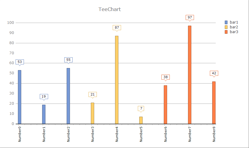

The following code:
      Random rnd = new Random();
      int count = 0;
      for (int i = 1; i < 4; i++)
        Bar bar = new Bar(tChart1.Chart);
        bar.MultiBar = MultiBars.SideAll;
        for (int j = 0; j < 3; j++)
          bar.Add(rnd.Next(100));
          tChart1.Axes.Bottom.Labels.Items.Add(count, "Number" + count.ToString());
          count++;
gives me this:
Is this more along the lines of what you would expect?
