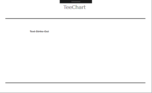

We are working with WPF Tchart objects that have strikeout (TchartObject.Graphics3D.Font.Strikeout whereasTchartObject is of type Steema.TeeChart.WPF.TChart ).
The strikeout disappears when the font is less than 8pt.
Is it a known issue? Is there a workaround for strikeout?

Which version of TeeChart.WPF.dll are you using? The latest public version using this code:
    private void TChart1_AfterDraw(object sender, Steema.TeeChart.WPF.Drawing.Graphics3D g)
      g.Font.Size = 6;
      g.Font.Strikeout = true;
      g.TextOut(100, 100, "Text Strike Out");
gives me this:
is this the same as what you get at your end?

Thanks Christopher,
It looks like the functionality we are missing.

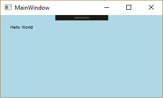

imd-soft wrote: Is there a way to show the strikeout for TextFormattingMode.Display for smaller fonts?
I'm not sure. It does seem the problem is with WPF and not TeeChart. Here's a UserControl you can test to see what I mean:
  public partial class UserControl1 : UserControl
    public UserControl1()
    protected override void OnRender(DrawingContext drawingContext)
      Rect clientRect = new Rect(RenderSize);
      if (clientRect.Height == 0) clientRect.Height = 300;
      if (clientRect.Width == 0) clientRect.Width = 400;
      drawingContext.DrawRectangle(Brushes.LightBlue, null, clientRect);
      Typeface font = new Typeface(new FontFamily("Verdana"), FontStyles.Normal, FontWeights.Normal, FontStretches.Normal);
      FormattedText text = new FormattedText("Hello World", CultureInfo.CurrentCulture, FlowDirection.LeftToRight,
        font, 6 * 1.4, Brushes.Black, null, TextFormattingMode.Display);
      text.SetTextDecorations(TextDecorations.Strikethrough);
      drawingContext.DrawText(text, new Point(20, 20));
      base.OnRender(drawingContext);
and this is what it gives me:
imd-soft
Posts: 11
Joined: Tue Mar 29, 2016 12:00 am
Re: Strikeout not shown for font less than 8pt
Post by imd-soft » Sun Apr 23, 2017 2:56 pm
Could you open a call regarding this issue to Microsoft .Net framework support?
