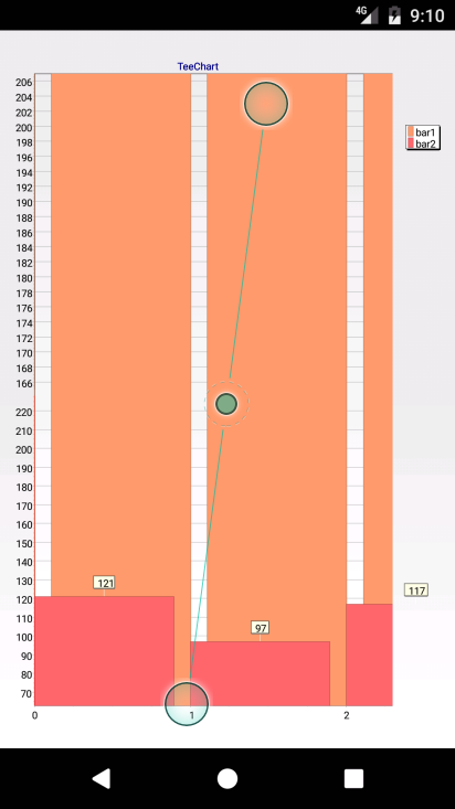

Post by Sandra » Tue May 16, 2017 9:52 am
Hello yang ching,
Firstly, I would like inform you that if you add a custom axis is needed assign it to a series. I have modified the code you sent us because it works properly with custom axes and seems zoom works fine as is shown in image below:
