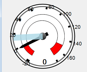

OK... So... We use dial gauges all over the place and I'm finally ready to make them look better!
This is what they look like now:
Not great, right?

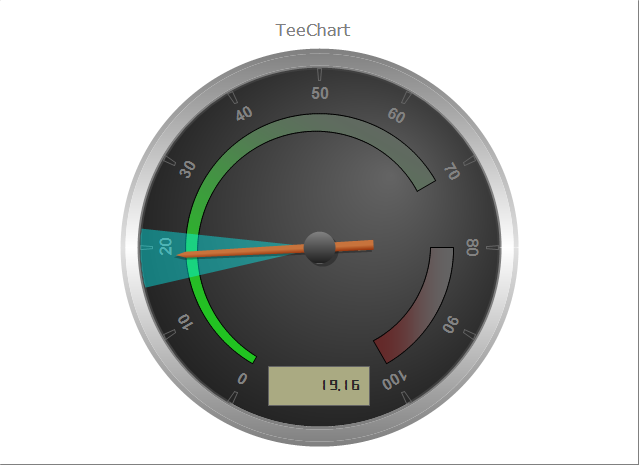

This one sure looks a lot nicer, doesn't it?
I'm fine with how the red bands come out but I would like things to look a little more finished and I like having that blue band (just a visual cue of kind of how things should be) _behind_ the needle (well, and triangular).
Or, if you prefer, man... Our implementation of this is awful. Can you help out?

To be clear, the first gauge is our implementation of the circular gauge. The second image is something we've done in another language on another platform with other tools. It would sure be nice if we could get our first gauge to look closer to that. Thx!

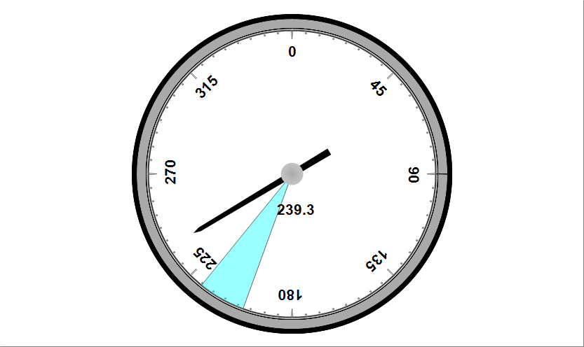

I obtain this:

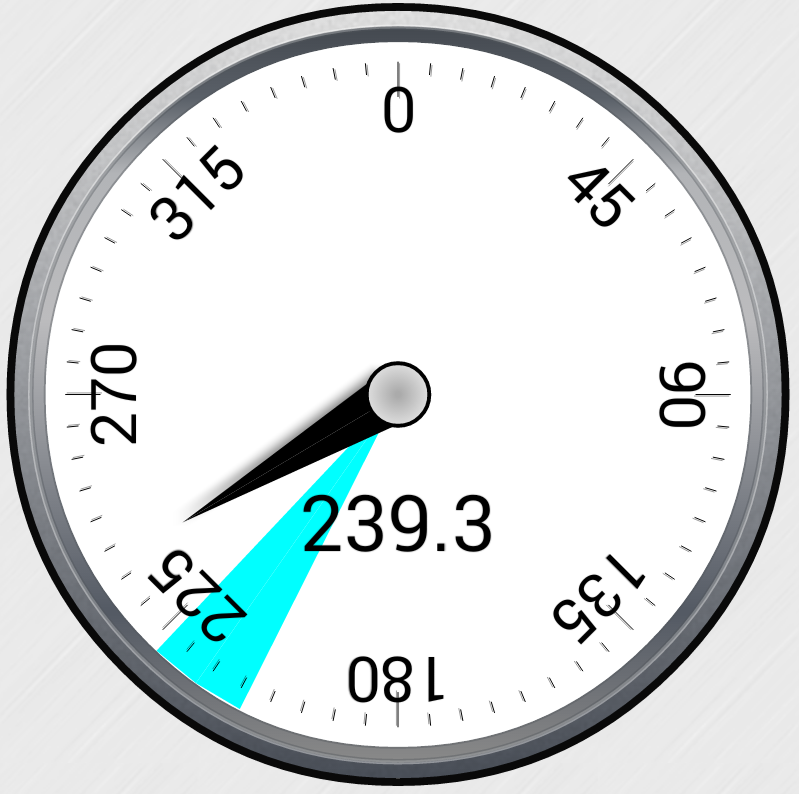

Of course, it will be a pleasure. This following code:

gives me the following:
is this near what you're looking for?

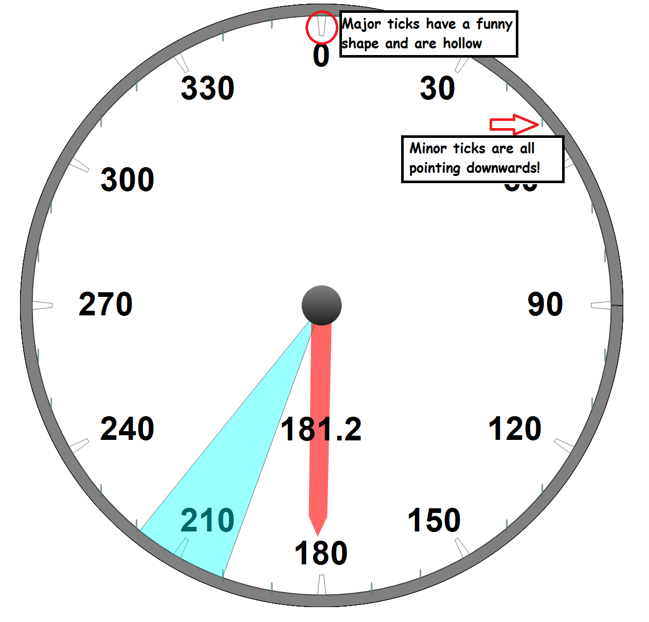

Well, we're closer.
I guess I'd like the ticks to resize, too, frankly. And to be different, of course. "Of course" because the customer always wants more, right? Anyway, in the visual editor the ticks seem to always end up as binaries in resources. The ones I have right now are hollow circles and hollow rectangles. Not exactly what I'm looking for!
We did this one in another lifetime... But we manually drew all of those ticks. I guess... It doesn't really feel like I should be drawing those manually.
Anyway, that looked like this.
Anyway, if I just resize the ticks (see code) then weird things happen...
This image is large because you can't see the weirdness when it's small...
