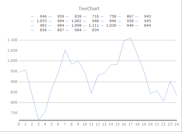

Using the latest public release of TeeChart, the following code:
gives me the following:
Which version of TeeChart are you using? Can you give me a simple code example which reproduces your problem?

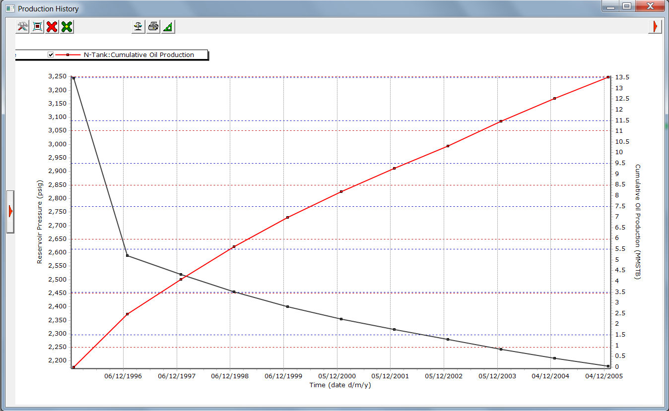

The version of TeeChart.dll is 4.1.2011.4193.
We use a wrapper but we end up calling the following:-
x_chart.Legend.Visible = true;
x_chart.Legend.LegendStyle = Steema.TeeChart.LegendStyles.Series;
x_chart.Legend.CheckBoxes = true;
x_chart.Legend.Alignment = Steema.TeeChart.LegendAlignments.Top;
When the plot is first created we get the plot shown in the attachment with the legend too far over to the left.
If you resive the plot or move the mouse over the data then the legend suddenly moves into the center.
Thanks for any assistance.

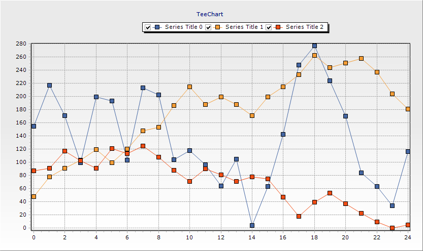

The oldest version I presently have installed on my machine is 4.1.2013.5280 - running the following code:
gives me:
Would you please be so kind as to run this code in a new WinForm project with just a TChart on the form?
for (int i = 0; i < 3; i++)
line.Pointer.Visible = true;
line.FillSampleValues();
line.Title = "Series Title " + i.ToString();
tChart1.Legend.Visible = true;
tChart1.Legend.LegendStyle = Steema.TeeChart.LegendStyles.Series;
tChart1.Legend.CheckBoxes = true;
tChart1.Legend.Alignment = Steema.TeeChart.LegendAlignments.Top;
