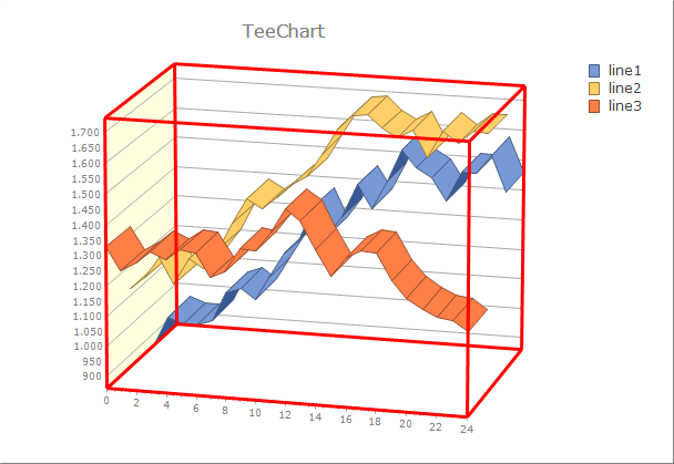

Yes, you can - here's some code that demonstrates the required calculation by drawing lines around the 3D cube of a 3D TChart:
      tChart1.Aspect.View3D = true;
      tChart1.Aspect.Orthogonal = false;
      tChart1.Aspect.Chart3DPercent = 80;
      tChart1.Aspect.Zoom = 75;
    private void TChart1_AfterDraw(object sender, Graphics3D g)
      Func<int, int, int, Point> CalcPoint = (x, y, z) =>
        return g.Calc3DPoint(x, y, z);
      int w = g.Chart.Aspect.Width3D;
      Rectangle r = g.Chart.ChartRect;
      Point[] lines = new Point[8];
      lines[0] = CalcPoint(r.Left, r.Top, 0);
      lines[1] = CalcPoint(r.Left, r.Bottom, 0);
      lines[2] = CalcPoint(r.Right, r.Bottom, 0);
      lines[3] = CalcPoint(r.Right, r.Top, 0);
      lines[4] = CalcPoint(r.Left, r.Top, w);
      lines[5] = CalcPoint(r.Left, r.Bottom, w);
      lines[6] = CalcPoint(r.Right, r.Bottom, w);
      lines[7] = CalcPoint(r.Right, r.Top, w);
      g.Pen.Color = Color.Red;
      g.Pen.Width = 3;
      g.Line(lines[0], lines[1]);
      g.Line(lines[1], lines[2]);
      g.Line(lines[2], lines[3]);
      g.Line(lines[3], lines[0]);
      g.Line(lines[4], lines[5]);
      g.Line(lines[5], lines[6]);
      g.Line(lines[6], lines[7]);
      g.Line(lines[7], lines[4]);
      g.Line(lines[0], lines[4]);
      g.Line(lines[1], lines[5]);
      g.Line(lines[2], lines[6]);
      g.Line(lines[3], lines[7]);
Which gives me:

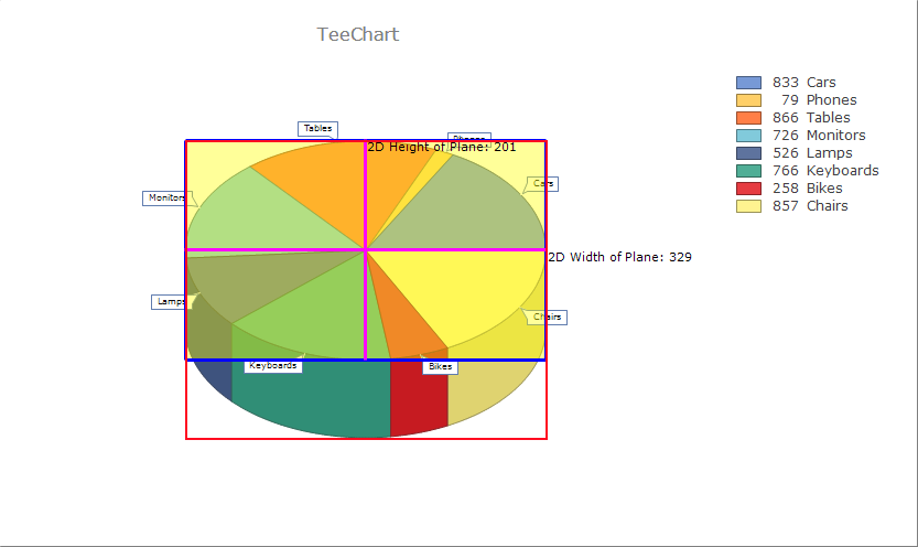

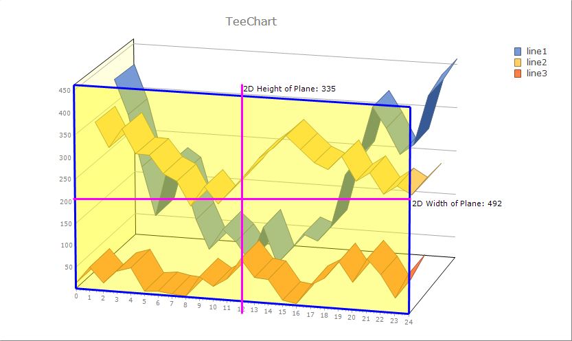

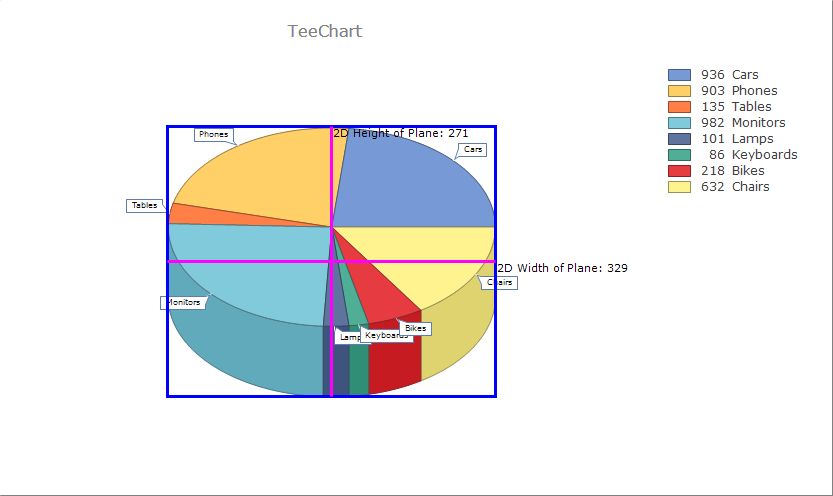

Okay, how about this code:
      //tChart1.Series.Add(typeof(Line)).FillSampleValues();
      tChart1.Series.Add(typeof(Pie)).FillSampleValues();
      Func<Point[]> PlotPoints = () =>
        Rectangle rect = (tChart1[0] is Pie) ? ((Pie)tChart1[0]).CircleRect : g.Chart.ChartRect;
        if ((tChart1[0] is Pie)) rect.Offset(0, -w);
        Rectangle r = rect;
        return lines;
      Action DrawFrame = () =>
        Point[] lines = PlotPoints();
        g.Pen.Width = 3;
      Action DrawPlane = () =>
        g.Pen.Color = Color.Blue;
        g.Pen.Width = 3;
        g.Brush.Color = Color.Yellow;
        g.Brush.Transparency = 60;
        Point[] polygon = new Point[4];
        Array.Copy(lines, polygon, 4);
        g.Polygon(polygon);
      Action Calc2DDimensions = () =>
        Rectangle rect = g.RectFromPolygon(4, polygon);
        int x, y;
        Graphics3D.RectCenter(rect, out x, out y);
        Point vertTop = new Point(x, y - (rect.Height / 2));
        Point vertBottom = new Point(x, y + (rect.Height / 2));
        Point horizLeft = new Point(x - (rect.Width / 2), y);
        Point horizRight = new Point(x + (rect.Width / 2), y);
        g.Pen.Color = Color.Fuchsia;
        g.Pen.Width = 3;
        g.Line(vertTop, vertBottom);
        g.Line(horizLeft, horizRight);
        g.TextOut(vertTop.X, vertTop.Y, "2D Height of Plane: " + rect.Height.ToString());
        g.TextOut(horizRight.X, horizRight.Y, "2D Width of Plane: " + rect.Width.ToString());
      //DrawFrame();
      DrawPlane();
      Calc2DDimensions();
Using the line series I obtain:
and using the pie series I obtain:
I hope this is of some help to you!

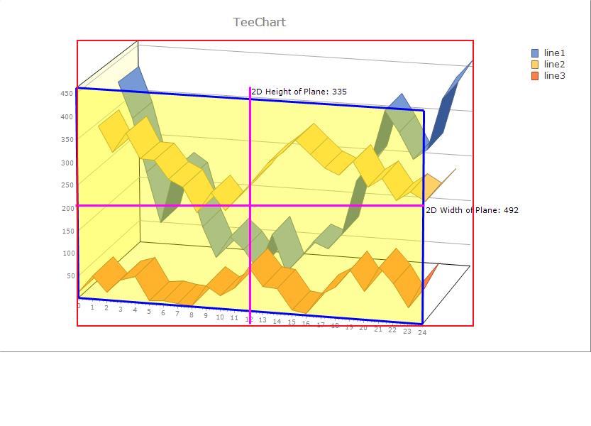

biqpaulson wrote: "Almost" -- ;-> If you refer to the two pictures that I included, you can see what we are looking for: "The area of the 3d chart projected into 2d space." We are looking for the RED area.
I see. Well, I may suggest that it shouldn't be difficult to obtain this area from what I've already given you. You could try something similar to this:
        //if ((tChart1[0] is Pie)) rect.Offset(0, -w);
        Rectangle r = rect;
        return lines;
      Action DrawCalcAnotherPlane = () =>
        g.Pen.Width = 3;
        List<Point> point = new List<Point>();
        point.Add(lines[0]);
        point.Add(lines[1]);
        point.Add(lines[2]);
        point.Add(lines[3]);
        point.Add(lines[4]);
        point.Add(lines[5]);
        point.Add(lines[6]);
        point.Add(lines[7]);
        Rectangle rect = g.RectFromPolygon(point.Count, point.ToArray());
        g.Brush.Visible = false;
        g.Rectangle(rect);
        int x, y;
        g.Pen.Width = 3;
      DrawCalcAnotherPlane();
which gives me:
and
biqpaulson wrote: Remember, the reason we want this is to be able to detect and control how "small" the chart gets, because sometime (since we offer a lot of controls for the user), the chart can get so small that nothing is rendered. We want to stop that from happening. Is there any way we can get this functionality?
Okay, if I'm not mistaken the technique I proposed to you worked for you with 2D charts - with any luck this conversation will help you get it to work with 3D charts as well. If not, do please let me know.
