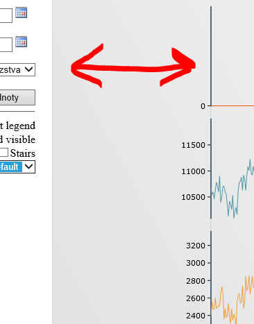

Hello guys,
I have problem with area, that is creating between border and chart itself.
With one chart line it is okay, but with more custom axis in the chart, distance between border and chart itself increases.
 Axis axis2 = new Axis(false, false, ch1);
 ch1.Axes.Custom.Add(axis2);
zmesP.CustomVertAxis = axis2;
Axis axis1 = new Axis(false, false, ch1);
ch1.Axes.Custom.Add(axis1);
zp.CustomVertAxis = axis1;
axis1.StartPosition = 0;
axis1.EndPosition = 22;
axis2.StartPosition = 25;
axis2.EndPosition = 47;
Thank you for your help.
Peter
Re: Gap between border and chart
Post by Christopher » Mon Nov 27, 2017 9:39 am
One way of controlling this space is by using the Panel class' Margin* properties, e.g.
      for (int i = 0; i < 5; i++)
      tChart1.Axes.Left.Visible = false;
      tChart1.Panel.MarginUnits = PanelMarginUnits.Percent;
      tChart1.Panel.MarginLeft = 15;
      int count = tChart1.Axes.Custom.Count;
      if(count < tChart1.Series.Count)
        Axis axis = new Axis(tChart1.Chart);
        tChart1.Axes.Custom.Add(axis);
        tChart1.Series[count].CustomVertAxis = axis;
        tChart1.Header.Text = "There are " + tChart1.Axes.Custom.Count + " custom axes";
