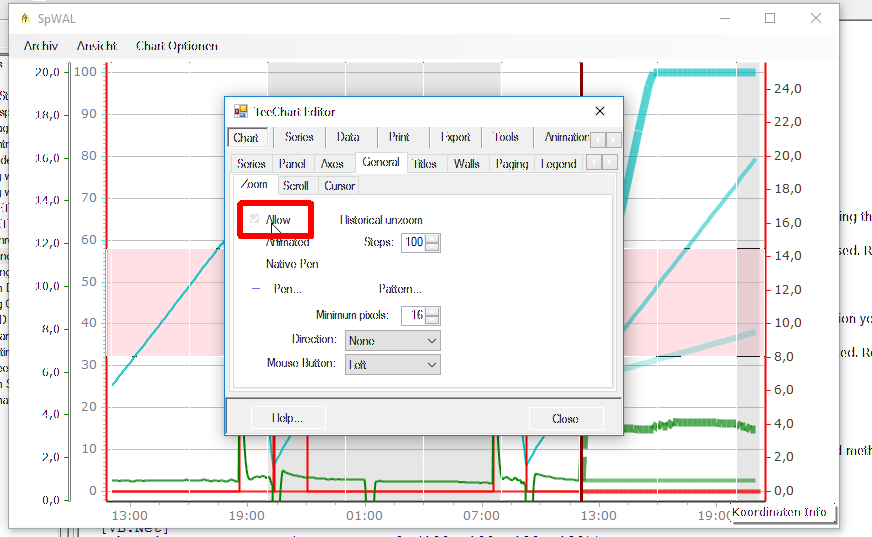

However now it seems that zooming is not working in some charts. In the old version zooming worked without problems. However, if I now open the Chart editor, Tab General I see that zoom is not "Allowed". I can activate it manually:
However zooming is still not possible.

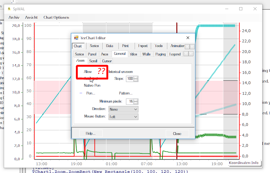

When I reopen the Chart Editor, I see that the "Allow"-Flag was reset.
What can I do (either manually or programmatically), to allow zooming again?

Wallenstein wrote: What can I do (either manually or programmatically), to allow zooming again?
The Allow property still works programmatically, although it has been deprecated. You can use the Direction property to enable or disable zooming for a particular direction, e.g.
			InitializeChart();
			//tChart1.Zoom.Allow = !tChart1.Zoom.Allow; <-deprecated
			tChart1.Zoom.Direction = tChart1.Zoom.Direction == ZoomDirections.Both ? ZoomDirections.None : ZoomDirections.Both;
