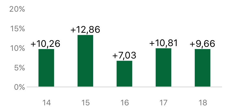

I'm trying to reproduce following designed version
DesignVersion

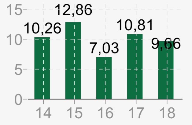

Current status
SteemaVersion
Screen Shot 2018-04-19 at 11.13.52.png (58.31 KiB) Viewed 25526 times

Some questions:
1. I'm unable to remove the grid dashes... tried Chart.Axes.Left.Grid.Visible = false without any luck
2. What is the best way to have tailored data labels that are different from the actual double values for the bar? So example show +10,26 instead of the real 10,26 value.
3. Same for the left labels, instead of 5 show 5%
4. Why aren't all bar labels 'above' the actual bar? ( cfr 9,66 label )
