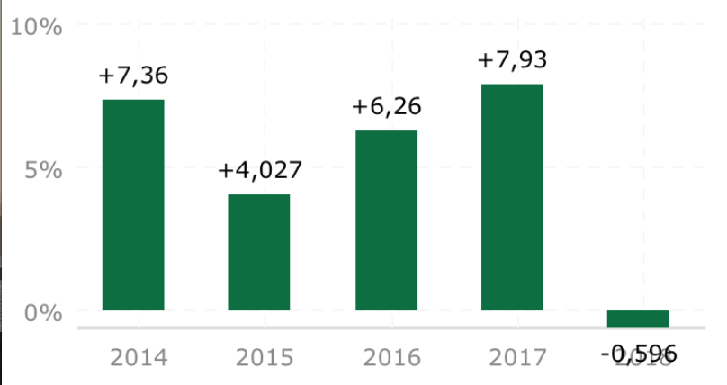

How do we compensate for the space needed to show negative bar marks?
Cfr screenshot
Screen Shot 2018-05-04 at 14.17.54.png (50.24 KiB) Viewed 23218 times
The last bar has a negative value and now masks the bottom axes value. Can we fix this with some offset and if yes how do we calculate that margin?
Side question, can we manipulate the position of the bar marks? So that they will always be above the bar instead of following the value and be below the bar for negative values?

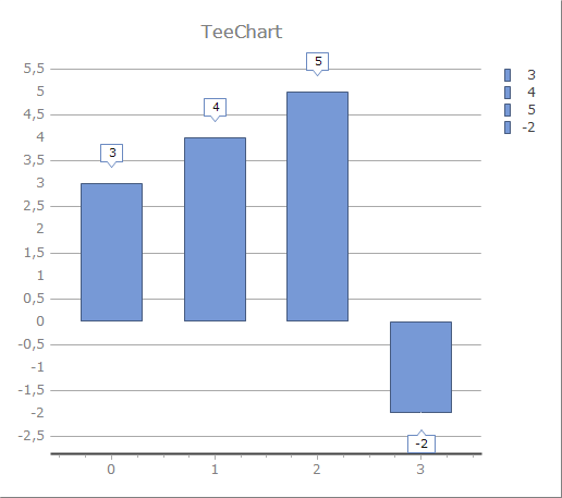

Using the latest version of the TeeChart.dll and the following code:
			Bar bar = new Bar(tChart1.Chart);
			bar.Add(3);
			bar.Add(4);
			bar.Add(5);
			bar.Add(-2);
I obtain this:
that is, TeeChart correctly calculates the margin in this default case. Could you please send me a simple code example of the code you're using to obtain the TeeChart in the image you sent? I can then add to this code to show you the options.

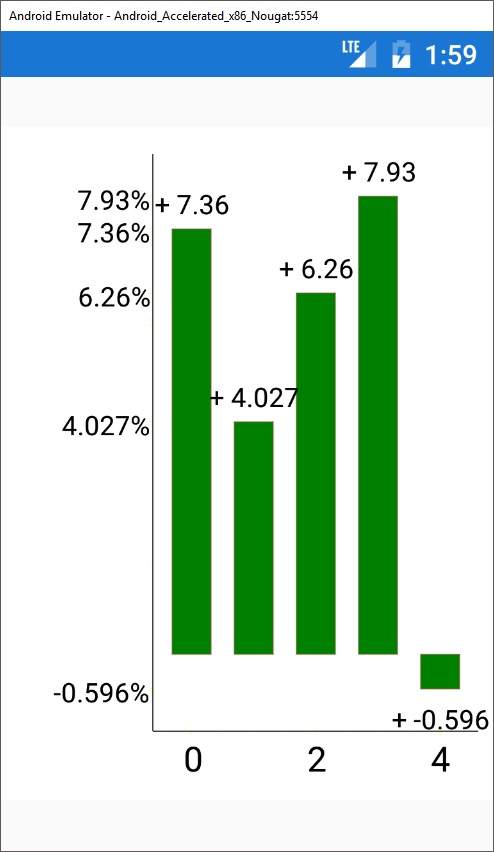

You can show the results I have gotten below:
Could you confirm us you're using latest Teechart for Xamarin.Forms version?
