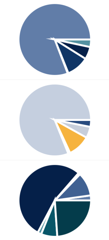

Any reason why the slice center points are not stopping in the center of the pie chart?
The values for the middle one are these by the way
pieData.Data.Add(new GraphData() { Value = 81, Color = Color.FromHex("#B9C4D8") });
pieData.Data.Add(new GraphData() { Value = 1, Color = Color.FromHex("#1D386D") });
pieData.Data.Add(new GraphData() { Value = 10, Color = Color.FromHex("#F5A623") });
pieData.Data.Add(new GraphData() { Value = 5, Color = Color.FromHex("#BBC3D3") });
pieData.Data.Add(new GraphData() { Value = 3, Color = Color.FromHex("#1D386D") });
Re: Pie chart values - off center slices
Post by Sandra » Wed May 09, 2018 12:46 pm
Hello Bank Van Breda,
I would like inform you that the Pen problems is added in Teechart Xamarin.iOS Bugzilla tracker to review the problem to upcoming maintenance release. Here's the link: http://bugs.teechart.net/show_bug.cgi?id=2033
On the other hand, finally, we have found a good solution, that allow to explode any pie slice. The code below show you how can do it:

I guess I'll wait for the bug fix... because setting each slice as exploded with value 5 has following visual effect.
Post by Sandra » Mon May 14, 2018 3:31 pm
I would like inform you we're working to fix the problem. We contact with you as soon as possible.
Post by Sandra » Thu May 17, 2018 12:40 pm
We have published a new TeeChart.Net for Xamarin.Froms maintenance release where the bug id2033 is fixed. You can download it from Client Download page
Post by Bank Van Breda » Fri May 18, 2018 2:27 pm
Thanks for the great support! Now works as expected :)
