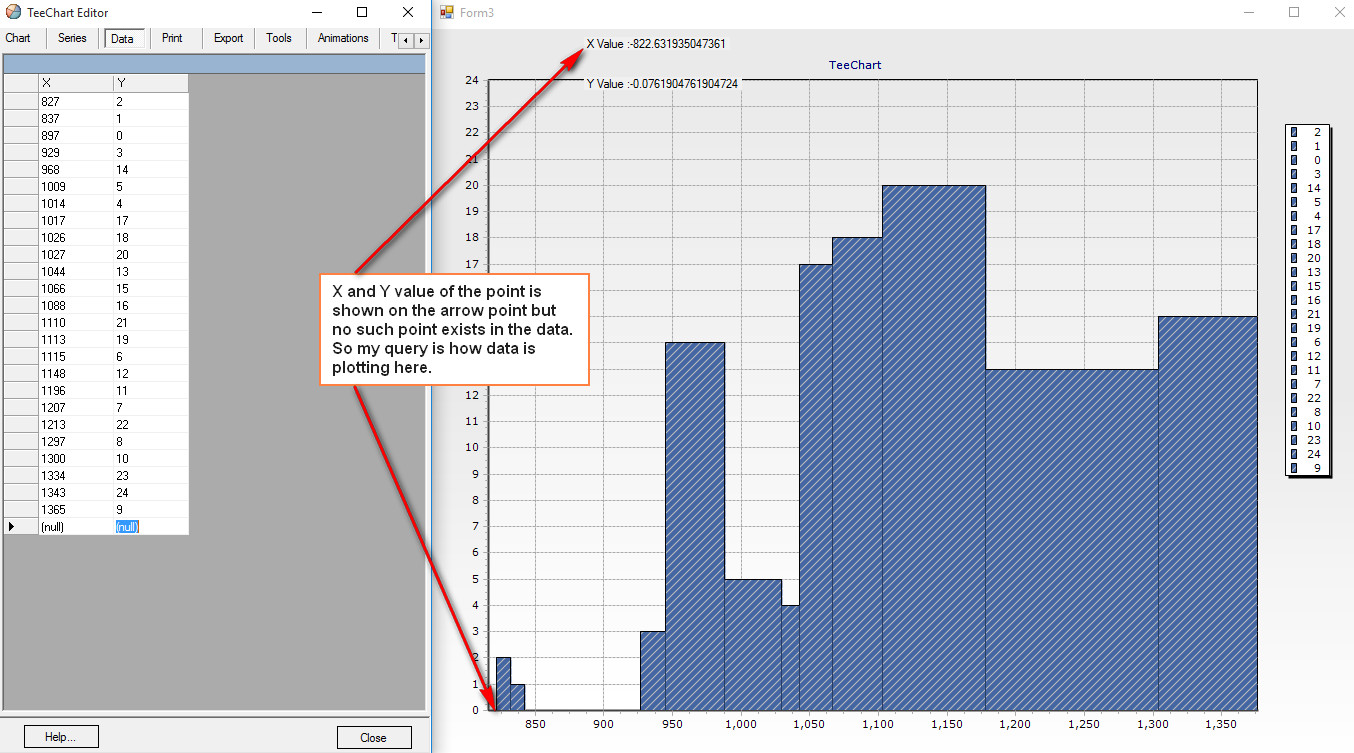

I have a problem in plotting data in histogram plot.
Currently i have plotted it with dummy data as shown in image.
histogram
But when i look data in chart and try to understand its plotting according to X and Y scale then plotting looks different with respect to data.
Means i am unable to understand how plotting is done on the data points those are not present in X,Y data list.
Please help me to understand the logic used behind the plotting of histogram.

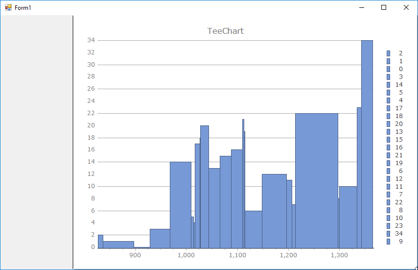

The Histogram series is optimized to draw series with equi-distant X values. Where data has disparate X values it is better to use an Area series with Stairs, e.g.
			double[] xvalues = new double[] { 827, 837, 897, 929, 968, 1009, 1014, 1017, 1026, 1027, 1044, 1066, 1088, 1110, 1113, 1115, 1148, 1196, 1207, 1213, 1297, 1300, 1334, 1343, 1365 };
			double[] yvalues = new double[] { 2, 1, 0, 3, 14, 5, 4, 17, 18, 20, 13, 15, 16, 21, 19, 6, 12, 11, 7, 22, 8, 10, 23, 34, 9 };
			if(xvalues.Length == yvalues.Length)
				Area series = new Area(tChart1.Chart);
				series.Stairs = true;
				series.Add(xvalues, yvalues);

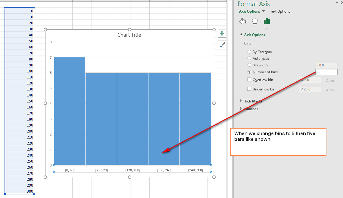

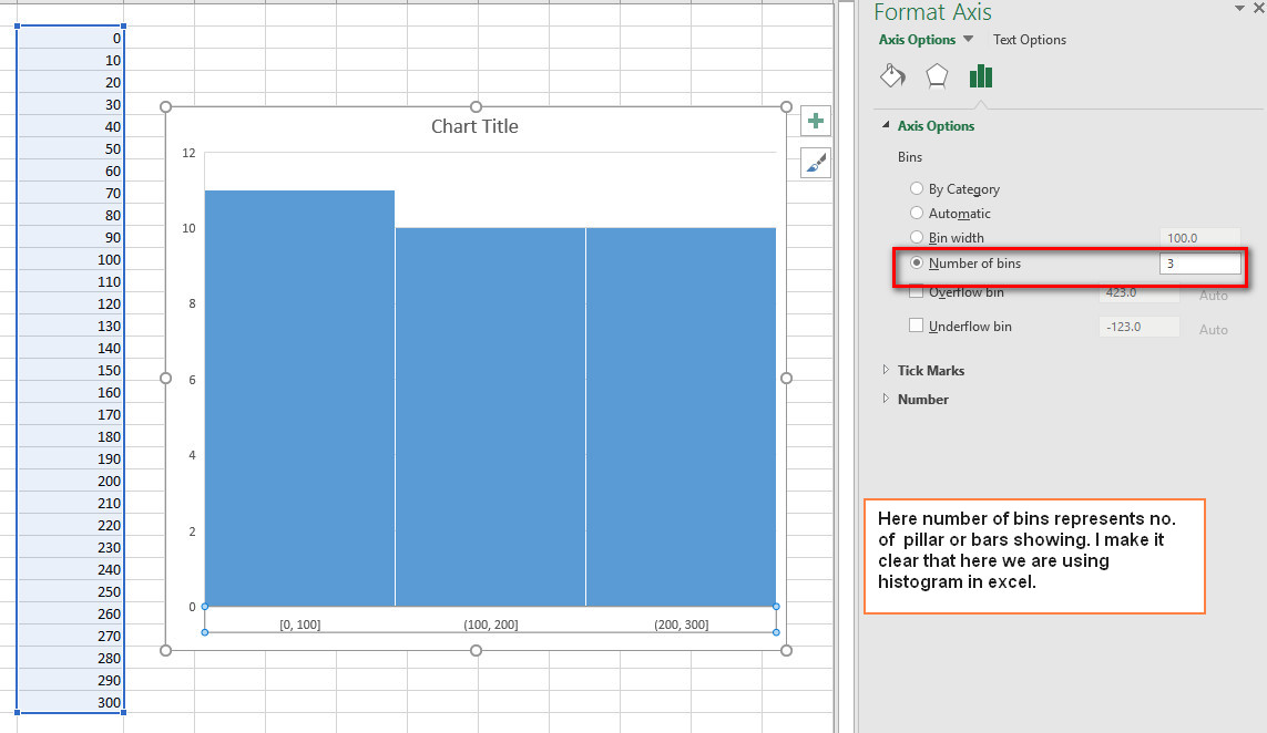

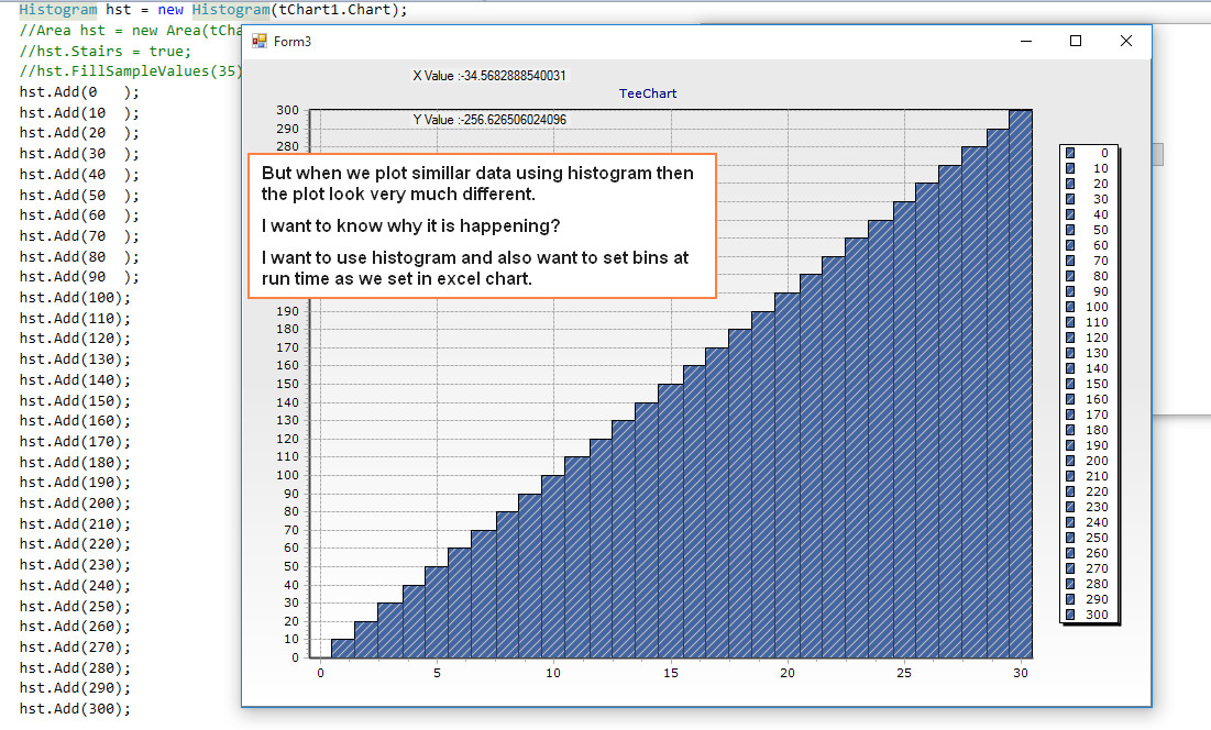

I have also gone through with excel charts here i have plotted my data. i m attaching images of same. On excel my data plotted correctly. i want to plot similar in teechart.
first image
As shown in first image data is plotted on histogram chart with 3 bins.
second image
As shown in second image i have changed number of bins to 5. And after changing number of pillar/bars increased.
third image
But in third image i have plotted same data with teechart but it plots data differently. why?
One more thing in teechart histogram, there is no property to set bins number. And my need is to change bins dynamically over the plotted data.
Kindly help i want to plot similar chart using teechart as plotted in excel.
