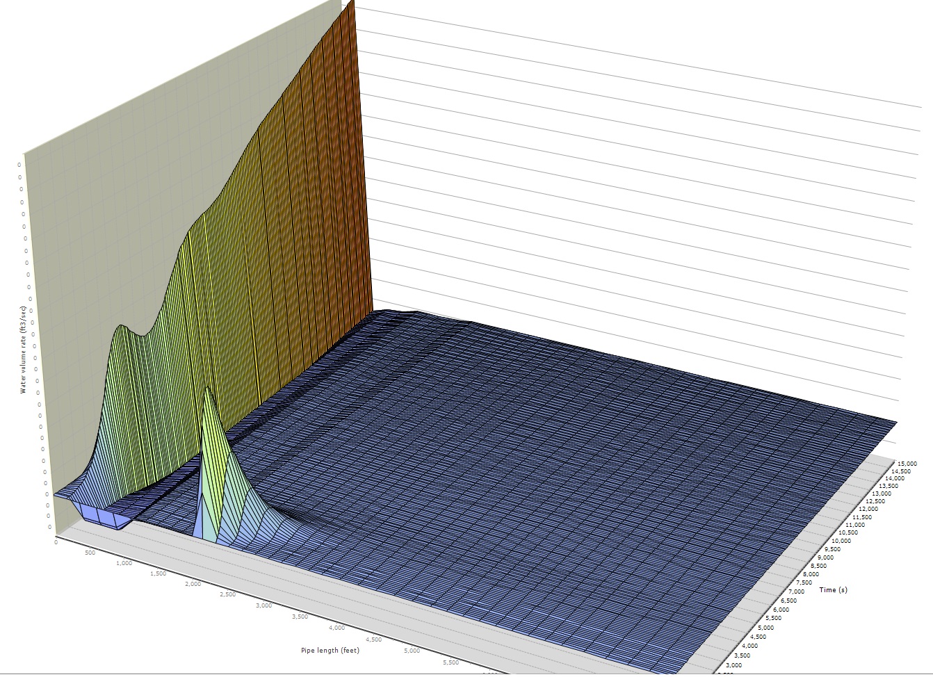

I have created a simple bi-variate normal distribution curve to demonstrate the problem (our actual data/code is obviously more complex).
A screenshot is included to demonstrate the actual data.

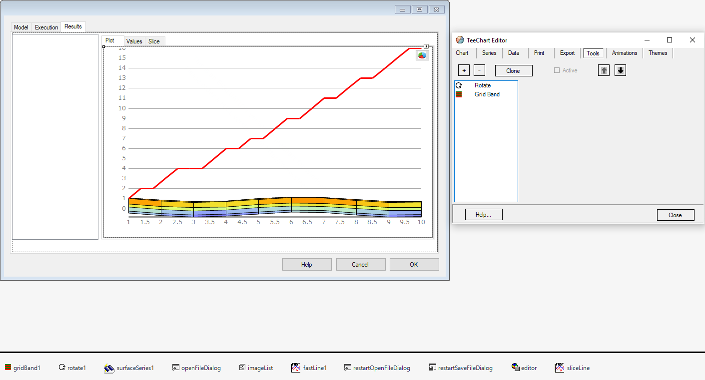

I have also tested our actual application with real data (see the screenshot in last post) and both the Mesh tearing and overflow error still exist ( to a lesser extent).
I am using a gridband, slice line, fast line and rotate tools ( something is still asking for version 4.1.2018.5046) when I display my plot ( I can find no trace of a version reference in my project, license etc)

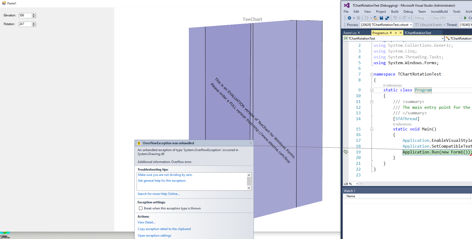

Here are the results using the BeforeDraw event up to the Zoom/Rotate overflow.
Hope this helps.

An unhandled exception of type 'System.OverflowException' occurred in System.Drawing.dll
Additional information: Overflow error.
c.f. with Actual data
windows\dwm\dwmapi\attribute.cpp(92)\dwmapi.dll!71833CF4: (caller: 718890ED) ReturnHr(115) tid(e2c) 80070006 The handle is invalid.
Rotation 255 Elevation 360 Zoom 66

I appreciate that the intermittent nature of the problem makes it hard to reproduce and we may have to reach an impasse.
I cannot reproduce the problem by entering the elevation and rotation value that caused a previous error to be thrown.
I can however make your demo app throw the error by repeatedly zooming and rotating (sometimes it requires a dozen or more steps).
Note - The only change I have made to your project is to change the target framework to (.NET 4.71 to match ours ) I appreciate the TeeChart Dll is built on 4.62.
Thank you for all your efforts to track this
