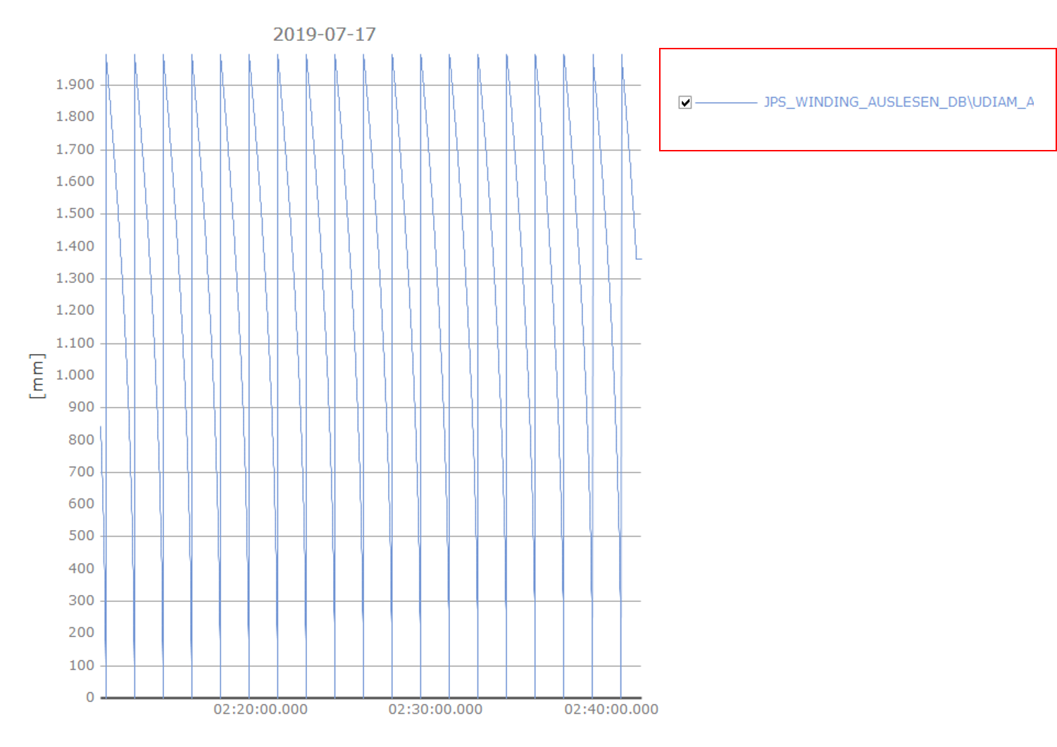

Hi all,
is it possible to set an individual text at the legend in the chart?
By now I just can chose the Series Name, but that is very long and so it take too much place in the chart.
Thanks in advance!

Hello.
I'm not from Steema team but looks like I know what to do :) - handle GetLegendText event, something like that:
private void tChart1_GetLegendText(object sender, GetLegendTextEventArgs e)
     //some checks (e. g. series index) if you need it
     if ((e.LegendStyle == LegendStyles.Series) && (e.Index == 0))
          //replace "-" with "" (or do whatever you like with legend text)
          e.Text = e.Text.Replace("-", "");
Good luck.
