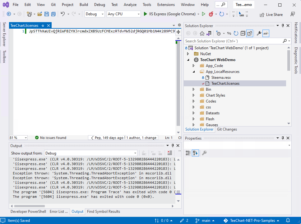

I think there's an example of an old project type in our GitHub sample repos, specifically this sample here. I've just updated this sample to version 4.2022.4.26, and using this version I can paste in my license information to the empty TeeChart.licenses file as shown here:
Screenshot from 2022-05-26 10-54-14.png (154.42 KiB) Viewed 5561 times

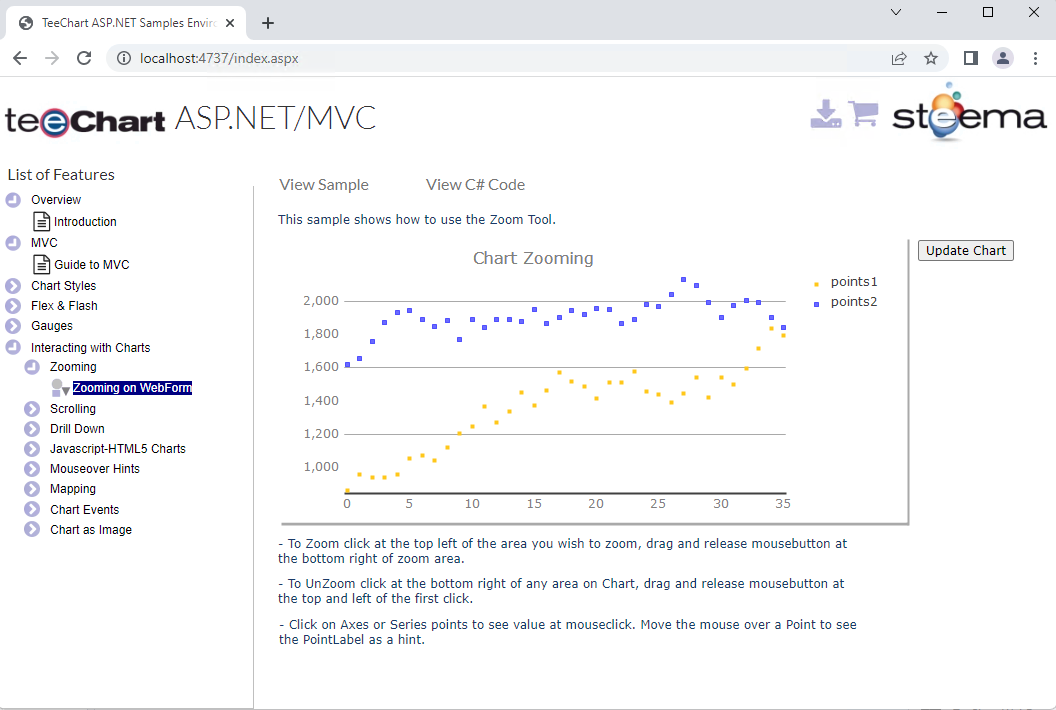

When I run this project the evaluation watermark is no longer shown:
Screenshot from 2022-05-26 10-54-49.png (92.27 KiB) Viewed 5561 times
Please be aware that, at this time, there is a problem with the latest NuGet (4.2022.5.23) in this project type, which means having to use 4.2022.4.26 until we have fixed it.
