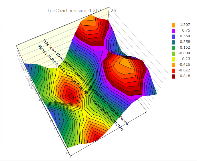

In .NET Framework 4.0 Windows Forms I get this:
Screenshot from 2022-10-04 12-31-31.png (279.76 KiB) Viewed 13098 times

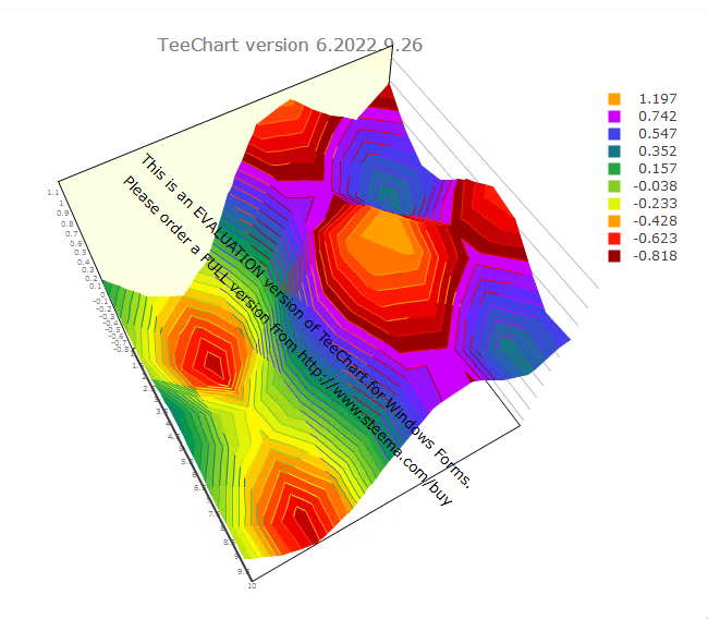

and in .net6.0 Windows Forms I get this:
Screenshot from 2022-10-04 12-30-01.png (236.63 KiB) Viewed 13098 times

Our conversation went wrong.
4.0.2009.62332
In version 4.0.2009.62332,
a rainbow color is completed with one color for each wire.
4.2022.9.26 dotnet6 core
In version 4.2022.9.26,
a rainbow color is completed with multiple colors for each wire.
4.2022.10.11 dotnet6 core
In the latest updated version 4.2022.10.11, all wires are the same color. Black
Like version 4.0.2009.62332, I want the rainbow to be drawn with a color for each wire

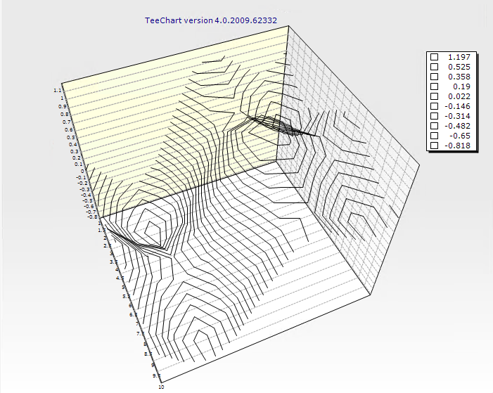

That code gives me:
Screenshot from 2022-10-19 11-02-44.png (243.57 KiB) Viewed 12882 times
The lines here are black—could you please modify this code so that I can reproduce what you want in version 4.0.2009.62332? Once I can reproduce it in this old version I can then have a look to see what the problem is in the present one.
