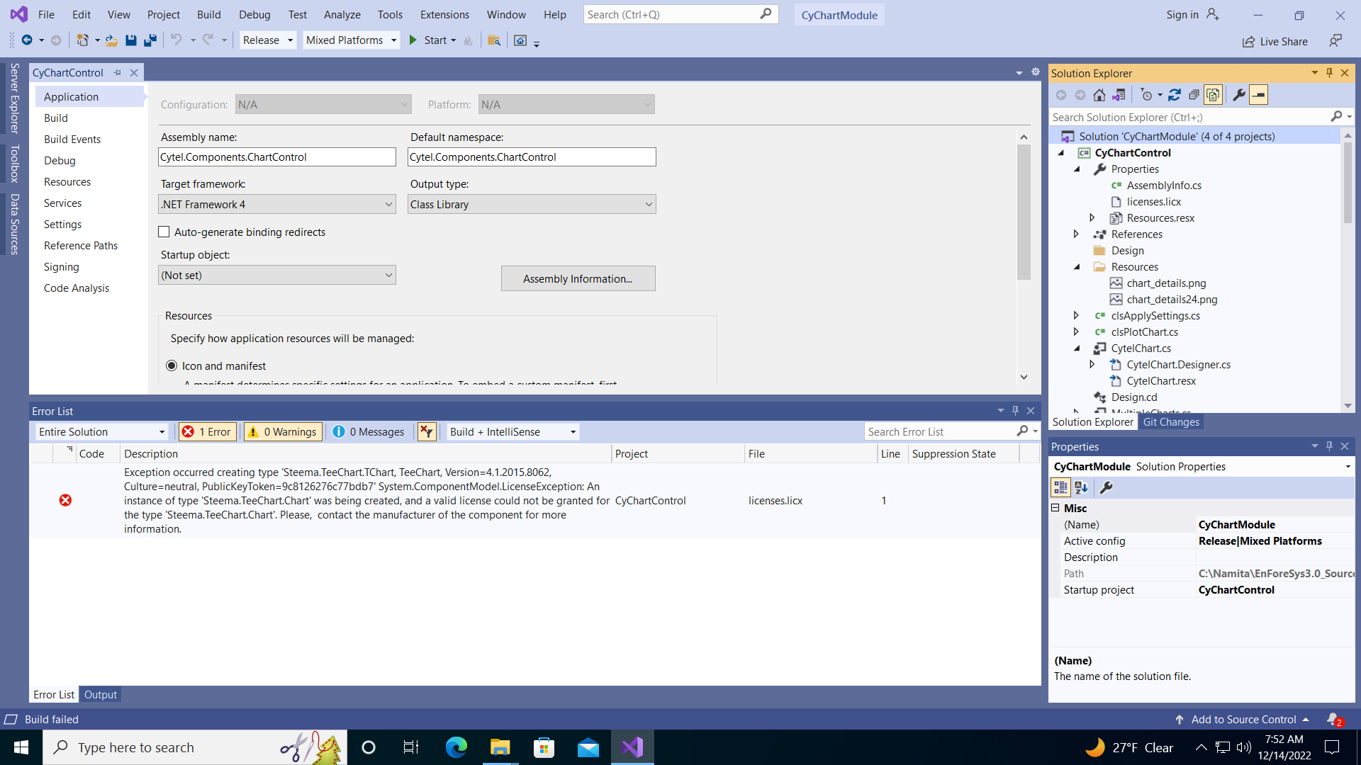

1)The developer team is facing issue while creating the build. Please see the attached document.
2)Also developer team found that the Debug folder is empty "C:\Program Files (x86)\Steema Software\Steema TeeChart for .NET Source Code 2015 4.1.2015.12160\Sources\TeeChart\bin\Debug"
It should contains the dll files.
Can you please help to resolve the issues.

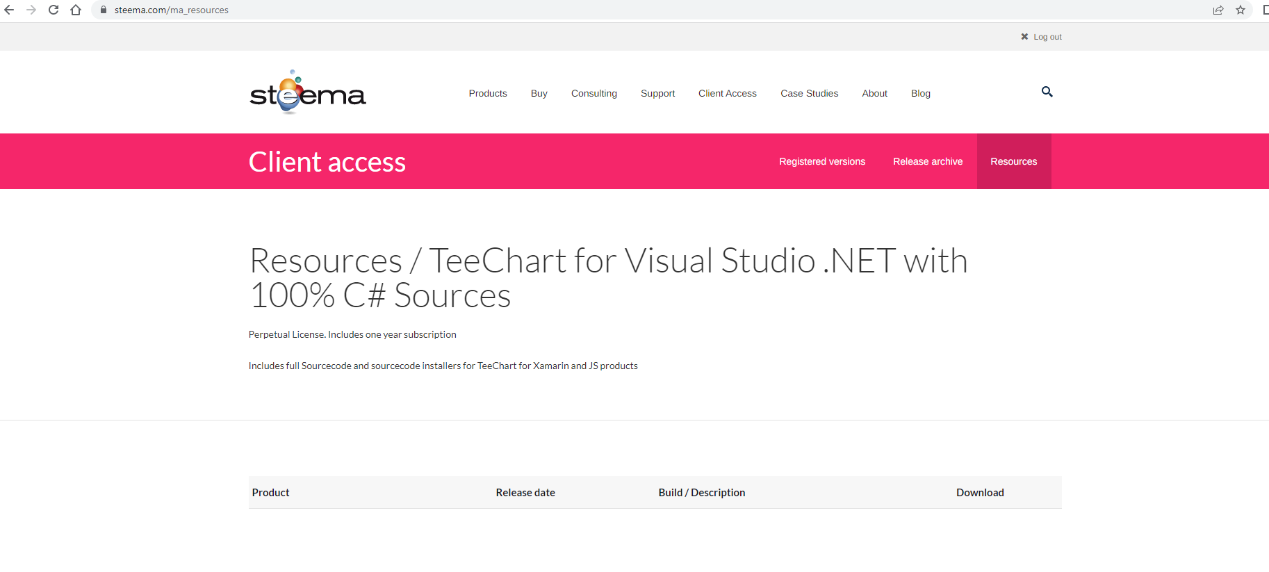

You may need to install a license on your machine--to do so, please log in to our web site and from the Resources tab download TeeRegV2010 and follow the instructions once this app has started.

Thanks much for reply. I tried to download the TeeRegV2010 from the path you mentioned. But i can not see any specific path to download it. Please see the snapshot.
And just to update you, the development team is using Visual Studio 2019. is it causing any issue?

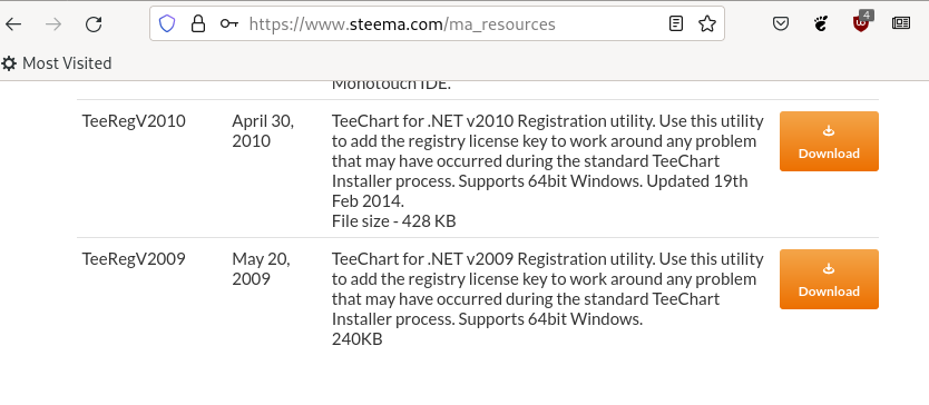

yes, you're on the right page—if you scroll down a bit you will come to TeeRegV2010, and as you can see in the image I posted there's an orange download button on the right.
