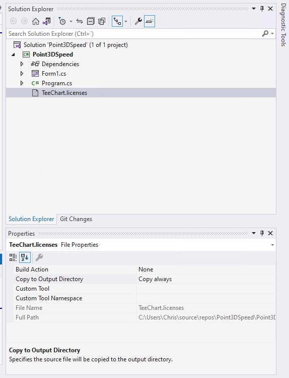

yes, yes there is, you don't have to embed the license. As long as the license is in the same directory as the TeeChart.dll then it should work—for example, a simple project built in Release with the license set to 'Copy always':
Screenshot from 2023-01-12 13-46-18.png (33.71 KiB) Viewed 7933 times

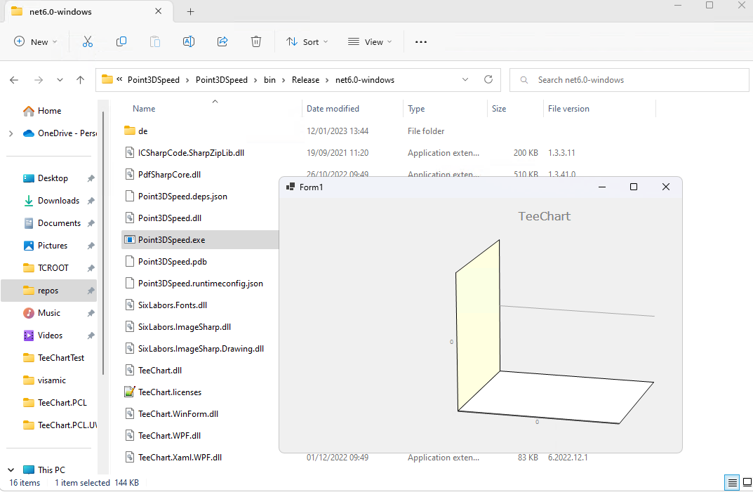

If we then double-click on the exe, the watermark disappears:
Screenshot from 2023-01-12 13-45-45.png (84.35 KiB) Viewed 7933 times
