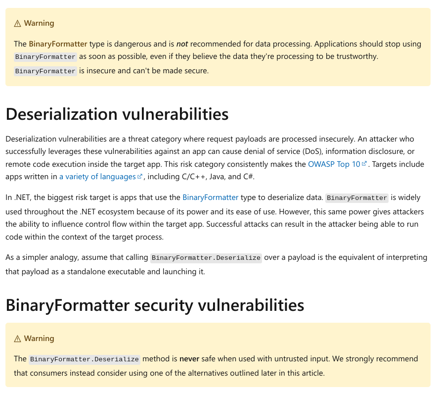

TeeChart's Template Export format is not compatible, as things stand, between the .NET Framework 4.x versions and our .NET 5/6 versions. The reason for this is that the .NET Framework 4.x versions use the BinaryFormatter class which Microsoft does not recommend for production code:
Screenshot from 2023-04-14 10-46-57.png (159.38 KiB) Viewed 14444 times
This strong recommendation was already made by the time we partially re-wrote TeeChart for .NET 5.0, and it was this which caused us to take the decision to drop BinaryFormatter in favour of JSON serialization.
