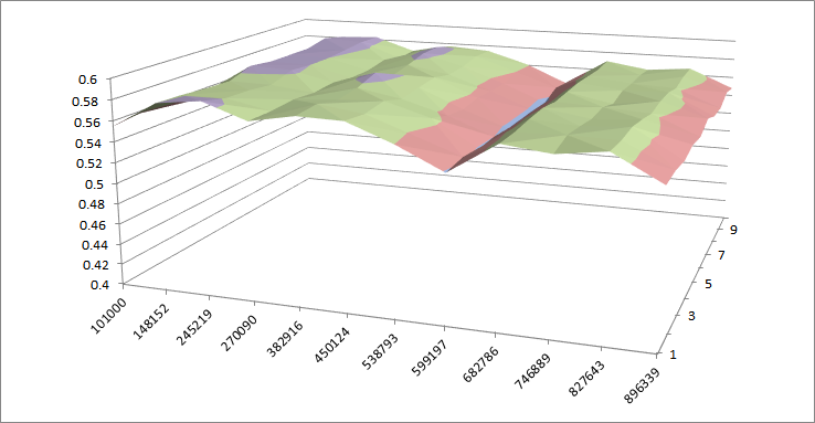

I recently purchased teechart bussiness version.
I plotted the graph by adding line and fastline as series to teechart.
Additionally, I want to draw a surface-type graph like the attached picture file, but I don't know how.
I'd be grateful if you could tell me how.

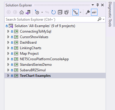

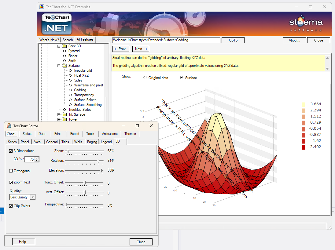

Of course. The quickest way would be to have a look at some examples, which you can do by downloading our git repo from GitHub here. If you open the Visual Studio solution under /WinForms/NET Framework/All-Examples.sln you will see: Running the TeeChart Examples and then navigating to the Surface series, we can see: Note that we can change from a 2D to a 3D view by double clicking on the yellow textbox area to bring up the Chart Editor, as shown in the screenshot above.
