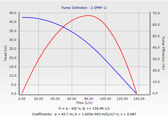

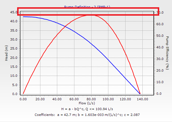

As they say, a picture is worth a thousand words. So, this post is going to rely on some screen shots.
Graph with Top Line
In the above image, note the top line that is present in the graph. It is "highlighted" by the red rectangle around it. This graph is using v2009.
Graph without Top Line
In this image, note that the top line is not present. This happens for ALL our graphs, not just the one we have pointed out here. This image is using TeeChart released in April. We do plan to update to the latest to get recent bug fixes.
We have been unsuccessful in finding the setting to bring this line back.
Please let us know if there is a workaround or if you will need to look into this further. If possible, we'd like to have that line back so we have as much consistency with prior releases as possible.

Re: Top Line in Graph
Post by Christopher » Thu Jun 22, 2023 4:38 pm
Hello Kris,
Kris C wrote:
Thu Jun 22, 2023 11:21 am
I think this might be the back wall pen, e.g.
            var bar = new Line(tChart1.Chart);
            bar.FillSampleValues();
            tChart1.CurrentTheme = ThemeType.TeeChart;
            tChart1.Walls.Back.Visible = true;
            tChart1.Walls.Back.Pen.Visible = true;
            tChart1.Walls.Back.Pen.Width = 3;
            tChart1.Walls.Back.Pen.Color = Color.Red;
Screenshot from 2023-06-22 18-38-23.png (31.44 KiB) Viewed 20959 times
