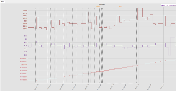

First, when i plot a lot of data the graphic starts to get a bit laggy you can see what happens when we try to Zoom. As well, the NearestPoint Event to the mouse starts to be a bit unresponsive. With the 2016 version this was not a problem:

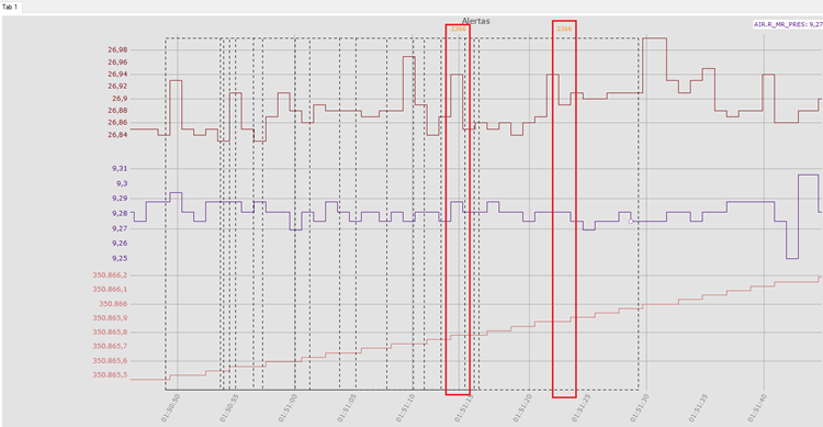

The second problem that i have experienced with the 2023 version is that some line maks are not drawn, we have marked with red boxes where they should supposed to be:

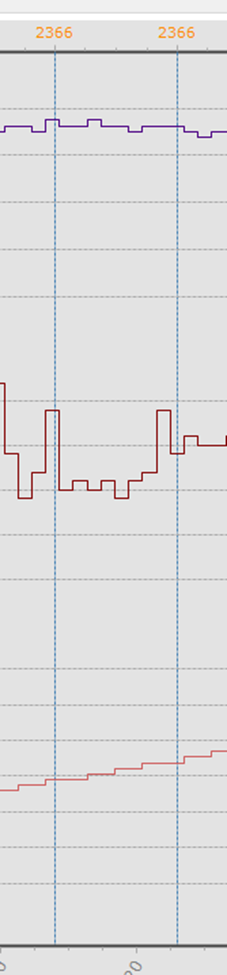

And using the 2016 version you can see what am i expecting in the red boxes above (the blue lines):
If you would be so kind, we're going to need a Minimal, Reproducible Example to be able to reproduce this issue with precision at our end and try to fix it for you. We have a location on our website where you can upload a zip file with your project.
