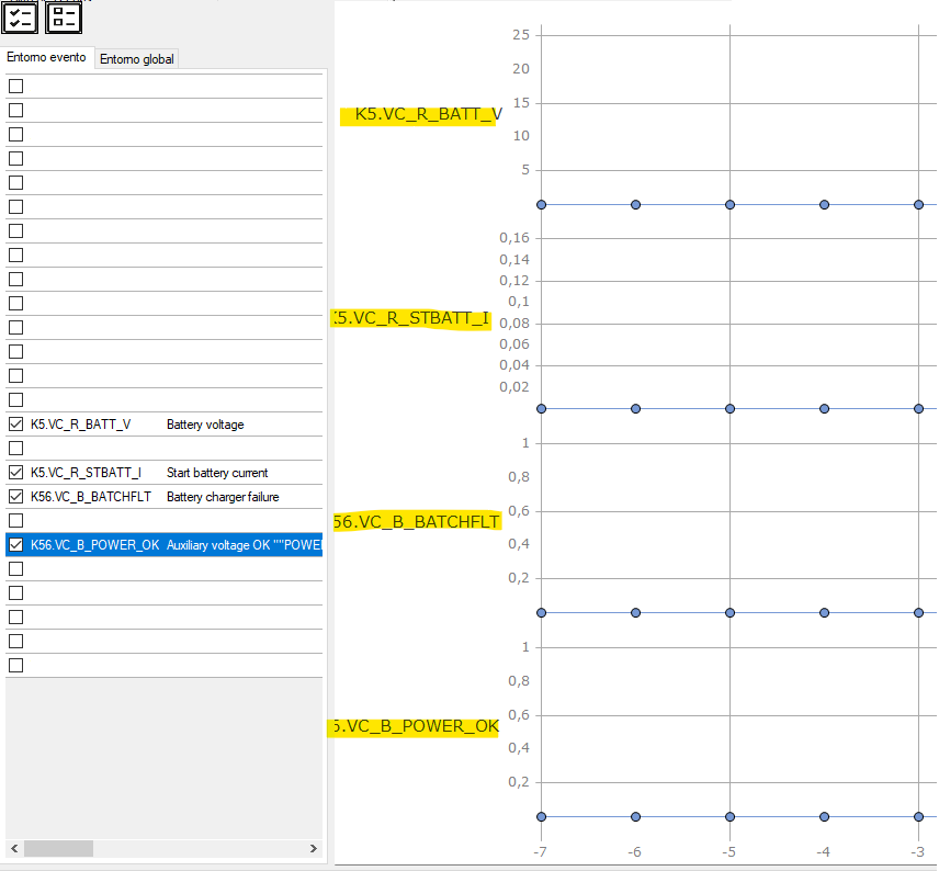

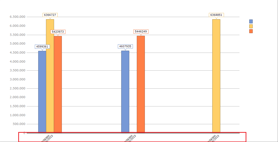

When I plot data in the chart, the title name goes out of the chart and you can not read it.
The same happens with the variables or labels assigned to the axis.
Is there any way to make TeeChart to respect the text adapting the chart size to it in order to fit everything and make it readable?
Thank you.

By turning off a default speed optimization to stop the unnecessary recalculation of label sizes, I think you can achieve what you want, e.g.
            var bar = new Bar(tChart1.Chart);
            bar.Add(1, "A long label for bar one");
            bar.Add(10, "A long label for bar one");
            tChart1.Axes.Bottom.FixedLabelSize = false;
            tChart1.Axes.Bottom.Labels.Angle = 45;
