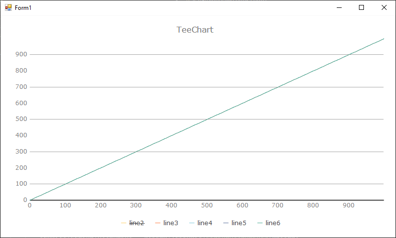

I am plotting 6 series on a tchart. In the first series the legend is not visible and the series is not visible. When plotting the signals, it looks like it is 1 off. Line 2-6 should be visible. Also when clicking on line 2 in the legend, line 3 seems to change.
        Steema.TeeChart.TChart tChart1;
            this.Controls.Add(tChart1);
            tChart1.Axes.Bottom.Visible = true;
            tChart1.Axes.Left.Visible = true;
            tChart1.Axes.Right.Visible = false;
            LoadData();
        private void LoadData()
            tChart1.Legend.Alignment = Steema.TeeChart.LegendAlignments.Bottom;
            for (int count = 0; count < 6; count++)
                Series line = new Line();
                tChart1.Chart.Series.Add(line);
                for (int i = 0; i < 1000; i++)
                    line.Add(i, i);
                if (count == 0)
                    line.Visible = false;
                    line.Legend.Visible = false;
