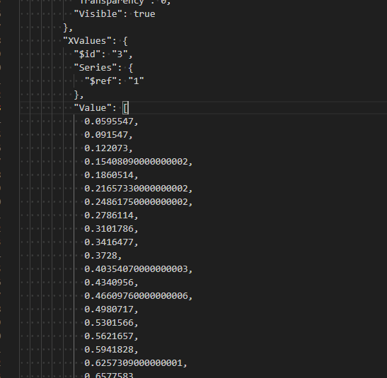

When exporting a template with the flag IncludeData set to false the data seems to be included. I tried it on .net framework and it seems to work correctly there. Here is the code.
		Steema.TeeChart.TChart tChart1;
            this.Controls.Add(tChart1);
            tChart1.Axes.Bottom.Visible = true;
            tChart1.Axes.Left.Visible = true;
            tChart1.Axes.Right.Visible = false;
            LoadData();
            TemplateExport template = tChart1.Export.Template;
            template.IncludeData = false;
            tChart1.Export.Template.Save("template.json");
        //    tChart1.Import.Template.Load("template.json");
		private void LoadData()
            tChart1.Legend.Alignment = Steema.TeeChart.LegendAlignments.Bottom;
            Series line = new Line();
            line.Marks.FollowSeriesColor = true;
            tChart1.Chart.Series.Add(line);
            for (int i = 0; i < 1000; i++)
                line.Add(i, i);

Thank you for reporting this bug. We have seen the issue and are working to resolve it.
Sorry for the inconvenience.

Please note; this issue has been resolved for the latest available TeeChart update.
