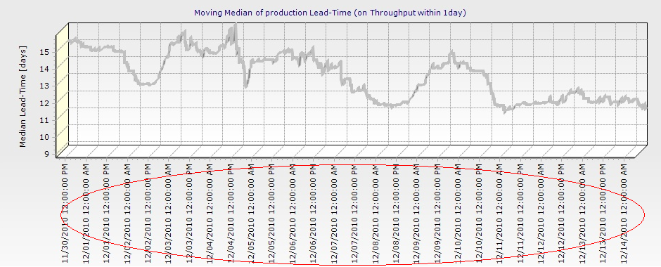

Hi Sandra,
Thanks for your reply. I already tried setting the dateTime format string but it displays the date as follows
11/21/2010 12:00:00 AM
11/21/2010 12:00:00 PM
11/22/2010 12:00:00 AM
11/22/2010 12:00:00 PM......as follows
I have a DateTime variable which has both date and time value in it.
code snippet
ltTrend is the line series chart
ltd.DETMEDIANTREND.STORETS - datetime type( this has both date & time value I want to display this exact value in the bottom axis. I dont want to use any Enumerabels like DateTimeSteps)
ltd.DETMEDIANTREND.MEDIALLT - double type
ltTrend.Series[0].Add(ltd.DETMEDIANTREND.STORETS, ltd.DETMEDIANTREND.MEDIALLT);
ltTrend.Series[0].XValues.DateTime = true;
see the atachtment for reference.
Thanks,Venu

Hello Venu,
Ok.I recommend that customize labels of bottom axis as do in next example:
        InitializeChart();
    Steema.TeeChart.Styles.Line Series1;
    Steema.TeeChart.Tools.ZoomTool tool1;
    System.IO.MemoryStream tmpChart;
    protected void InitializeChart()
        Steema.TeeChart.Chart ch1;// = WebChart1.Chart;
        tmpChart = new System.IO.MemoryStream();
        if (Session["ch1"] == null)
            ch1 = WebChart1.Chart;
            tool1 = new Steema.TeeChart.Tools.ZoomTool(WebChart1.Chart);
            tool1.ZoomPenColor = System.Drawing.Color.OliveDrab;
            ch1.Panel.Gradient.Visible = false;
            ch1.Walls.Visible = false;
            Series1 = new Steema.TeeChart.Styles.Line(ch1);
            Random rnd = new Random();
            DateTime today = DateTime.Today;
            TimeSpan oneDay = TimeSpan.FromMinutes(30);
            Series1.XValues.DateTime = true;
            for (int i = 0; i < 10; ++i)
                Series1.Add(today, rnd.Next(100), System.Drawing.Color.Red);
                today += oneDay;
            ch1.Axes.Bottom.Labels.Items.Clear();
            for (int j = 0; j < Series1.Count; j++)
                ch1.Axes.Bottom.Labels.Items.Add(Series1.XValues[j], DateTime.FromOADate(Series1.XValues[j]).ToString());
            ch1.Axes.Bottom.Labels.Angle = 90;
            ch1.Export.Template.Save(tmpChart);
            //save template to a Session variable
            Session.Add("ch1", tmpChart);
            //retrieve the session stored Chart
            tmpChart = (System.IO.MemoryStream)Session["ch1"];
           //set the Stream position to 0 as the last read/write
          //will have moved the position to the end of the stream
            tmpChart.Position = 0;
           //import saved Chart
            WebChart1.Chart.Import.Template.Load(tmpChart);
            WebChart1.Chart.Axes.Bottom.Increment = Steema.TeeChart.Utils.GetDateTimeStep(Steema.TeeChart.DateTimeSteps.ThirtyMinutes);
            CheckZoom(WebChart1);
    private void CheckZoom(Steema.TeeChart.Web.WebChart wChart)
        System.Collections.ArrayList zoomedState = (System.Collections.ArrayList)Session[wChart.ID + "Zoomed"];
        zoomedState = ((Steema.TeeChart.Tools.ZoomTool)wChart.Chart.Tools[0]).SetCurrentZoom(Request,
           zoomedState);
        // System.Drawing.Bitmap bmp = WebChart1.Chart.Bitmap((int)wChart.Width.Value, (int)wChart.Height.Value);
        if (zoomedState == null)
            Session.Remove(wChart.ID + "Zoomed");
            Session.Add(wChart.ID + "Zoomed", zoomedState);
If previous code doesn't work as you like, let me know.
