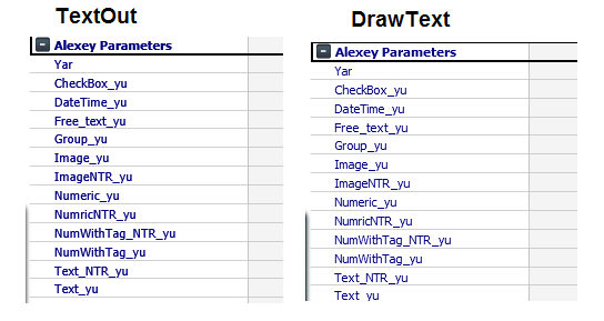

Re: TeeChart WPF - Cant see text in XAML
It's not a good solution for us.
The original idea was to use TextOut. We had display problems with it.
In our software we use sometimes a lot of text that is shown with small fonts. When using TextOut, the text looks very blurry and unclear.
After a small research i understood that is a known problem in WPF and Microsoft fixed it on FormattedText. The solution for us was to construct FormattedText with TextFormattingMode.Display flag. When choosing this option, all font metric calculations are GDI-Compatible, which are more suitable for displaying small font text.
I've added a screenshot with the two methods.
Idan
Idan

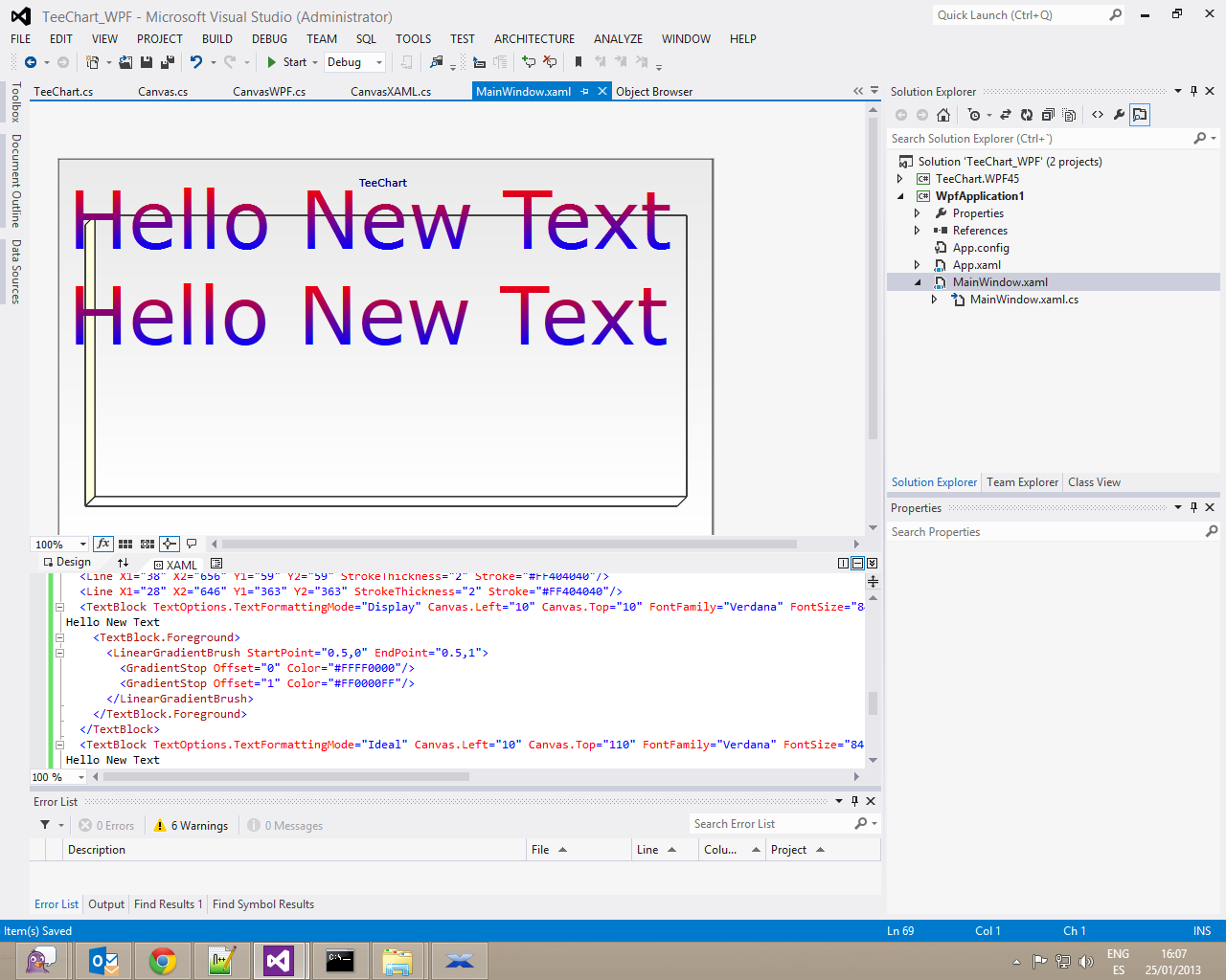

Okay, I think I have a solution for you. In the new version of TeeChart.WPF.dll, you will be able to do something similar to this:
The Aspect.TextFormattingMode will allow the TextFormattingMode to be set globally, or you can set it for individual texts as in the AfterDraw code. Below is an image of what the XAML looks like (using the VS designer XamlPadX is too old for this property
Please be expecting a new TeeChart.WPF.dll to be sent to you via email for testing.
Thank you,
Christopher Ireland
tChart1.Aspect.TextFormattingMode = TextFormattingMode.Ideal;
tChart1.AfterDraw += tChart1_AfterDraw;
void tChart1_AfterDraw(object sender, Graphics3D g)
g.Chart.Aspect.TextFormattingMode = TextFormattingMode.Display;
g.Font.Brush.Gradient.Visible = true;
g.Font.Brush.Gradient.StartColor = Colors.Red;
g.Font.Brush.Gradient.EndColor = Colors.Blue;
g.Font.Size = 60;
g.TextOut(10, 10, "Hello New Text");
g.Chart.Aspect.TextFormattingMode = TextFormattingMode.Ideal;
g.Font.Size = 60;
g.TextOut(10, 110, "Hello New Text");
private void Button_Click_1(object sender, RoutedEventArgs e)
tChart1.Export.Image.XAML.Save(@"C:\tmp\chart.xaml");
Thank you,
Christopher Ireland

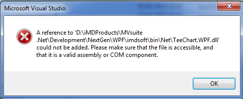

Sorry about the delay, i got the DLL and it's seems like the DLL is corrupted.
i cannot reference it in our project(added screenshot). i tried to see it content in the object browser and this is also cannot be done.
it is also strange that the size of the dll is 1.583mb and the original one was 2.998mb.
Idan.
Idan.
Hello MVuser6,
Sorry, you are right. I tested it before send you and it worked for me, but seems something has corrupted the assembly. At any rate, the latest version of TeeChartFor.net is published and you can download it in the download costumer page. Please, download last version and tell us if it works for you.

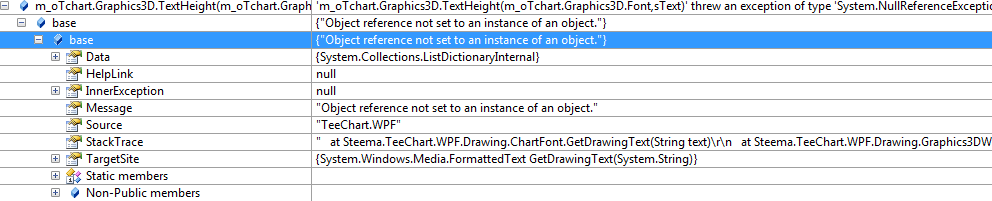

Thanks for the version.
i get an exception on the function TeeChart.Graphics3D.TextHeight(string).
The problem is NullReferenceException inside ChartFont.GetDrawingText.
the problem didn't occur before so i believe it related to the change.
Stack Trace:
at Steema.TeeChart.WPF.Drawing.ChartFont.GetDrawingText(String text)
at Steema.TeeChart.WPF.Drawing.Graphics3DWPF.MeasureString(ChartFont f, String text)
at Steema.TeeChart.WPF.Drawing.Graphics3D.TextHeight(ChartFont f, String text).
We need this function for height calculations.
Idan
Stack Trace:
Idan
- screen1.png (21.24 KiB) Viewed 29376 times
Hello MVUser6,
Thanks for information. I have added your request in bug list report with number [TW16016512]. We will try to fix it to upcoming maintenance releases of TeeChartFor.Net.
Hello MVUser6,
I inform you that the bug number [TW16016512] has already been fixed in the source code and is fixed to upcoming maintenance release of TeeChartFor.net. At the moment, you can use next code as a workaround:
Steema.TeeChart.WPF.Styles.Line line = new
Steema.TeeChart.WPF.Styles.Line(tChart1.Chart);
line.FillSampleValues();
Steema.TeeChart.WPF.Drawing.Graphics3D g)
g.Font.Chart = g.Chart;
g.TextHeight(g.Font, "Hi");
