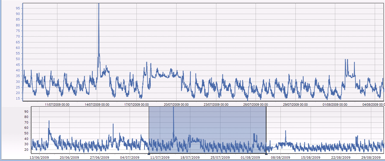

I have just tried I put:
((ScrollPager)chart.Tools[i]).SubChartTChart.Chart.CustomChartRect = true;
((ScrollPager)chart.Tools[i]).SubChartTChart.Chart.ChartRect = rect;
It runs, I put the same "rect" as the main chart, but the margin is not exactly the same:

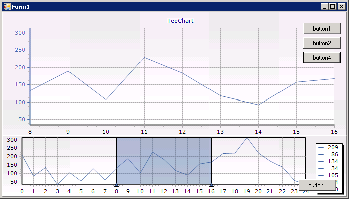

Please press buttons1, 2 and 4
http://193.145.251.126/pnp/files/vbQaVf ... croll2.zip

wakeup wrote:Please press buttons1, 2 and 4
The way to do this would be with code such as the following:

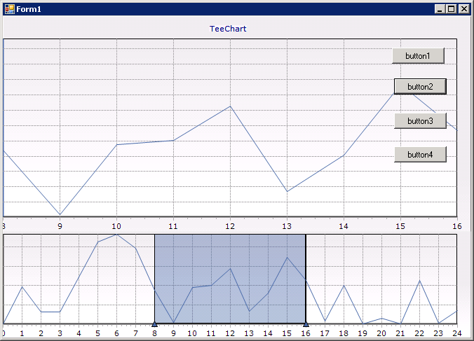

I tried with the new version and it seems not solve indeed the result is worse. Please find attached the example. Press button1 and then button2
http://193.145.251.126/pnp/files/PbDmQG ... Margin.zip

Which defect do you think has not been fixed?
Looking through this thread I see that id=632 is, in fact, fixed in the latest version. Try running the code in that bug report to see for yourself.

Tchart still is having problmes to set well the margin with scrollpager and custom axis. You can reproduce it with the example I sent in the previous post.
