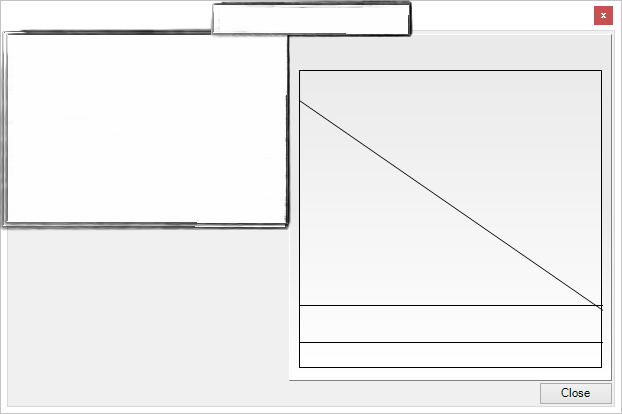

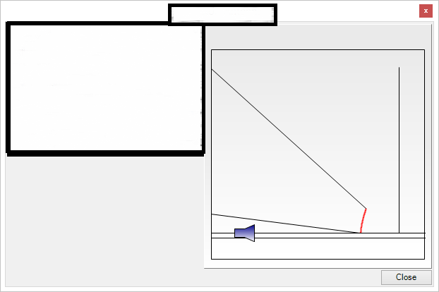

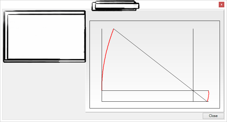

Re: How to fit all the lines into a chart
1.png, shows the drawing of the lines with IsoHoriz=true and m_Chart.BeforeDrawSeries += (sender, d) => m_Chart.Chart.Axes.Bottom.AdjustMaxMin(); event fired.
2.png, shows the drawing of the lines with IsoHoriz=true and //m_Chart.BeforeDrawSeries += (sender, d) => m_Chart.Chart.Axes.Bottom.AdjustMaxMin();
I try to draw all lines that will be bound to the Chart size and keeping the aspect ratio. Try to see something like 2.png in 1.png without re-sizing.
Also attached the re-sized Chart in 3.png.
- re-size
- 3.png (30.44 KiB) Viewed 20976 times
- //m_Chart.BeforeDrawSeries += (sender, d) => m_Chart.Chart.Axes.Bottom.AdjustMaxMin();
- 2.png (32.9 KiB) Viewed 20966 times
- lines out of chart.
- 1.png (27.55 KiB) Viewed 20971 times

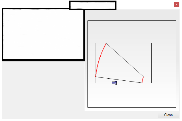

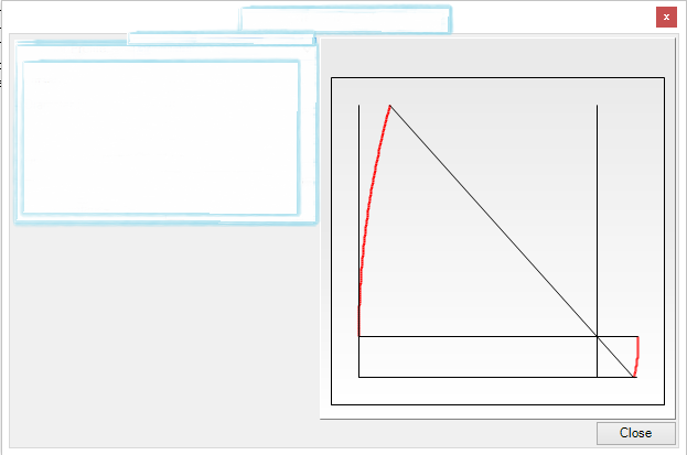

Thanks again.
I try to understand the problem now, it seems when using IsoHorizAxes or IsoVertAxes it tries to scale Horizontal or Vertical axis accordingly. This is required for me and it works fine.
Problem on scaling is that it tries to draw lines or points beyond the Chart rectangle.
* My requirement is to draw everything in a Chart rectangle and maintain aspect ration.
OnCreate.png: Drawing beyond the Chart rectangle.
AfterZoomingOut.png: Applying Chart.Zoom.ZoomPercent(100); 3-times.
I aim to implement something like in AfterZoomingOut.png, i.e., no matter what I do all the points or lines stay inside the Chart rectangle.
- AfterZoomingOut.png (18.48 KiB) Viewed 20959 times
- OnCreate.png (19.45 KiB) Viewed 20957 times

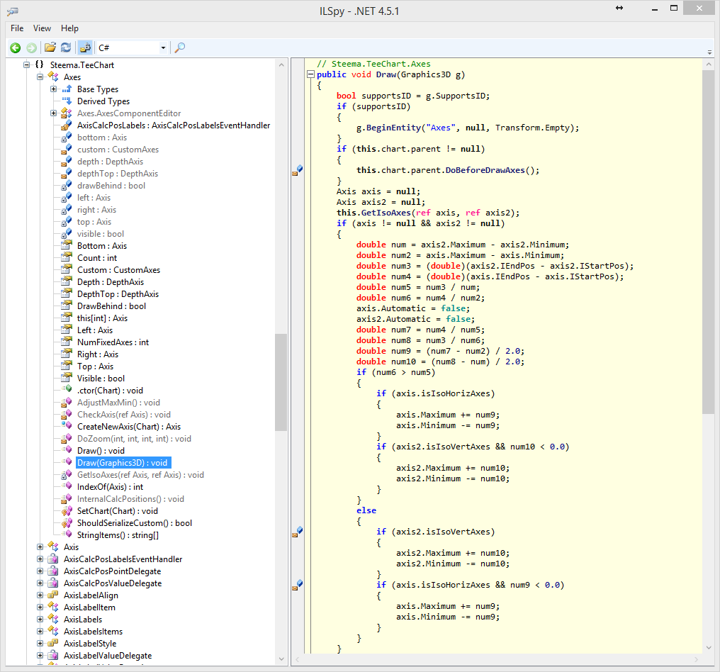

Maybe having a look at the TeeChart source code will give you a clearer idea of what these properties do ... using ILSpy to open TeeChart.dll, we can see the code in the Axes.Draw method:
What's happening here is that we take the value range of the two axes, that is, the difference between the maximum and minimum. Then we take the pixel range of the two axes, that is, the difference between the pixel position of the start of the axis and its end. From this we have two ratios, the pixels-per-value of the vertical axis (num5) and the pixels-per-values of the horizontal axis (num6). So, if IsoHorizAxes is set to true, a calculation is made to make the horizontal axis pixels-per-value ratio the same as the vertical axis. In your example, as the pixels-per-value ratio of the vertical axis is bigger than that of the horizontal axis, this means that when IsoHorizAxes is set to true the horizontal axis is made bigger (more pixels per value). That is why you are getting the effect you see, and that is why the only way to get the polygon entirely visible with the vertical and horizontal axis values you have is to set IsoVertAxes to true.
The only way to do this is to use IsoHorizAxes instead of IsoVertAxes.Raavi wrote: * My humble question is, Is it possible to bring the polygon into the Chart when the lines are set to
Slowly taking that code into my veins but I see it does not take Chart bounds into account.
I am not an expert in 2D-graphics but I assume that this feature is not available for consumption yet.
