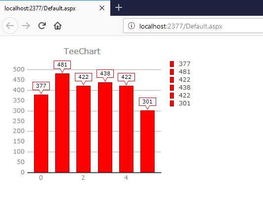

Hi, I made further research and found that a simple page with a teechart doesn't works ok.
I've attached a simple demo (without bin folder, packages folder nor Teechart.licences) that I cannot make it works fine.
Could you make it works and say me what is missing?
Thank you un advance

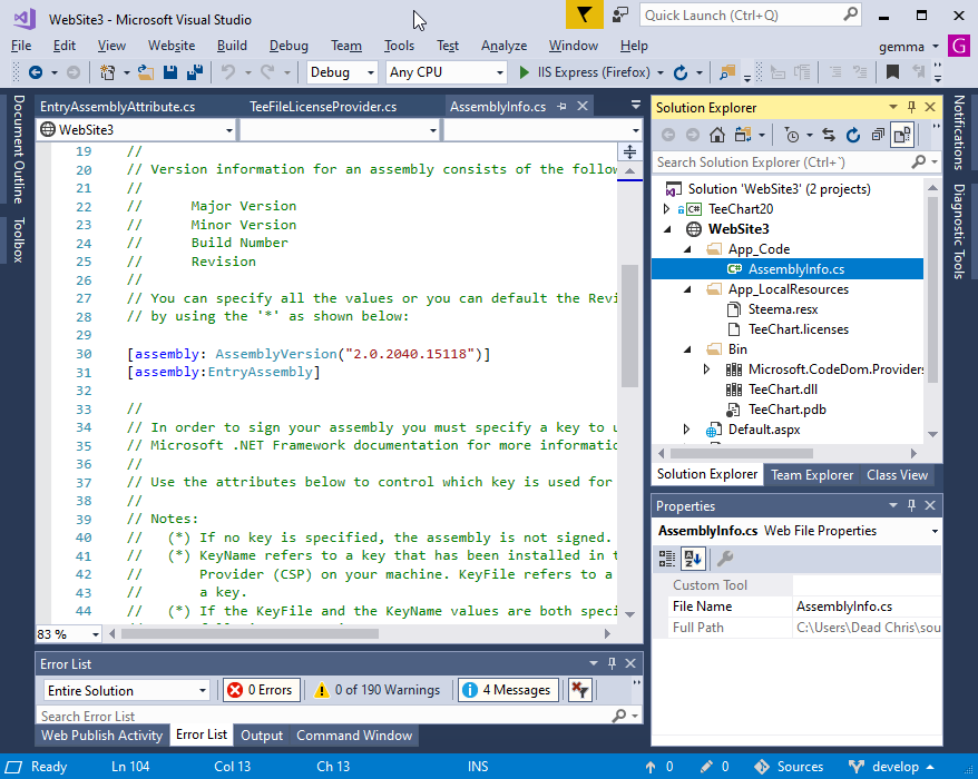

Post by Christopher » Mon Oct 07, 2019 6:38 am
I think this project was missing an AssemblyInfo.cs with the necessary EntryAssembly attribute in it:
With this added in the watermark disappears:

Post by Hermes » Mon Oct 07, 2019 3:51 pm
Hello, with this added, not only the sample but my site has also been fixed.
Thank you, and is good time to update the documentation :D
