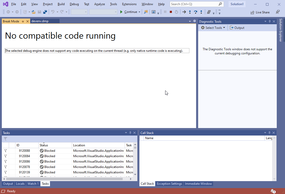

Having opened the file in Visual Studio 2019, the first thing I note is that TeeChart is not listed as one of the referenced modules:

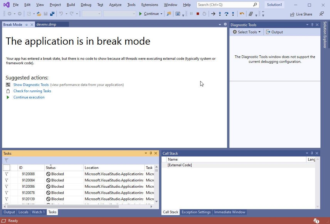

Then I run 'Debug with Managed Only':
And finally, after waiting nearly 30 minutes for all the debug symbols to download, I see the results of running 'Debug with Mixed':
Do you have any idea how I can use this dump to determine a problem related to TeeChart.WPF.dll, in the absence of any managed code to debug?
