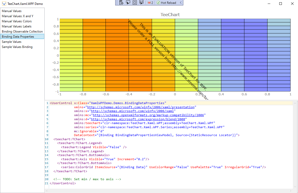

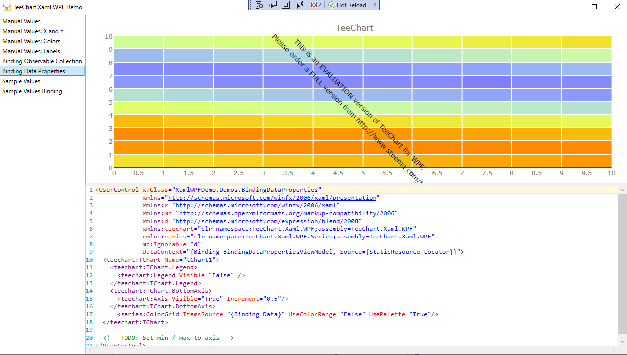

No. What I mean is that using the latest NuGet package, we can create a WPF application that doesn't reference TeeChart.Xaml.WPF:

Adding your data in at runtime:

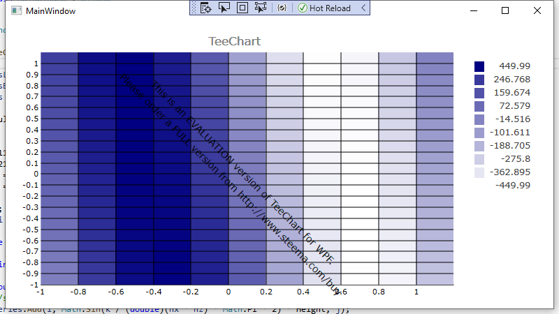

Gives us the following:

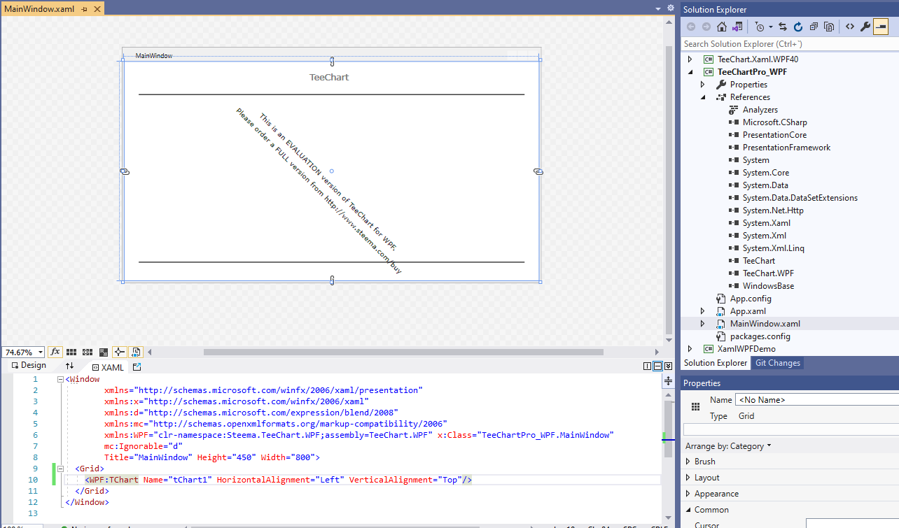

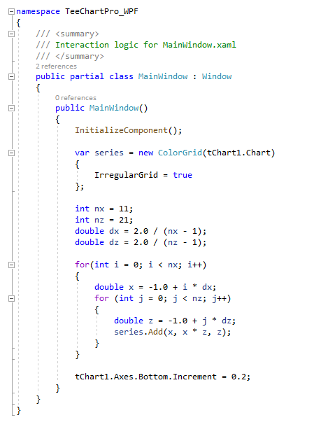

However, the TeeChart.Xaml.WPF assembly in the latest NuGet package does not contain the property IrregularGrid - we've added that in now, meaning that in a future version you will be able to do this:

To give you:
Screenshot from 2021-04-28 10-25-06.png (114.99 KiB) Viewed 42884 times

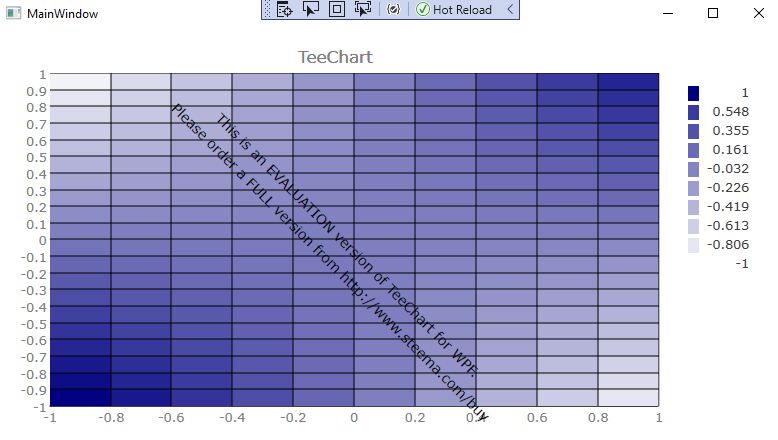

Which gives me this (a small bug in the present NuGet gives a slightly different result - this fix will be in the next NuGet):
Screenshot 2021-04-30 124313.png (57.18 KiB) Viewed 42865 times
However, this is more complex to achieve in Xaml, and would require Data binding to the Labels.Items property which is presently not available.

Which gives me the expected result (with the defect I mentioned earlier):
Screenshot 2021-05-03 111211.png (47.28 KiB) Viewed 42782 times

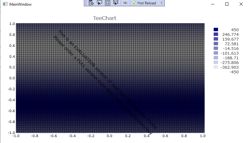

The two namespaces are still confusing and I will review your examples. As a final question, How does one control the axis labels using your example from the 4/30 post where I am using a regularGrid and redefining the axis labels? For example, in the example you used, if you set
int nx = 101;
int nz = 201;
How can I get each axis to display major tick mark and labels with an increment of 0.2? I tried setting chart.Axes.Bottom.Increment = 0.2; but that did not work.

No, because when we use Labels.Items for our labels, as in the 'retrofitting labels' code, TChart understands Axes labels as manually defined, so the automatic label properties such as Increment do not work.
Probably the easiest thing to do is to reduce the number of labels we collect in the dictionaries, i.e.
      int nx = 101;
      int nz = 201;
      double dx = 2.0 / (nx - 1);
      double dz = 2.0 / (nz - 1);
      int k = 0;
      for (int i = 0; i < nx; i++)
        double x = -1.0 + i * dx;
        for (int j = 0; j < nz; j++)
          double z = -1.0 + j * dz;
          //series.Add(x, Math.Sin(k / (double)(nx * nz) * Math.PI * 2) * Height, z);
          series.Add(i, Math.Sin(k / (double)(nx * nz) * Math.PI * 2) * Height, j);
          if(i % 10 == 0)
            if (!labelsBottom.ContainsKey(i))
              labelsBottom.Add(i, x.ToString("0.0"));
          if(j % 20 == 0)
            if (!labelsLeft.ContainsKey(j))
              labelsLeft.Add(j, z.ToString("0.0"));
          k++;
Screenshot from 2021-05-04 20-14-48.png (51.83 KiB) Viewed 42747 times

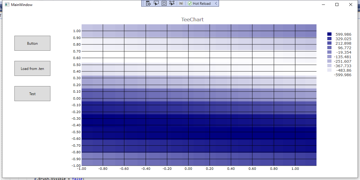

In the examples grid data we have been using you will notice that the y and z data is on a RegularGrid. It ends up being slightly irregular due to numerical rounding. It would be nice if ColorGrid would treat this as a RegularGrid, i.e. compute min, max, and step of x and z values and display the correct axis labels rather than the user having to retrofit labels in code. Also if the user specifies it as regularGrid then they only need to specify a vector of values for the axis rather than all the points for the 2D grid. Maybe my comments do not apply to the colorgrid since this can be a 3D dimension of shaded grid points. Maybe it would be best to define a new series called HeatMap which is an x-y plot with the data values in z being the map values. For example, HeatMap( double[] x, double[] y, double[,] data) x and y would be equally spaced data points. The legend would be a continuous color scale as shown in the attachment (This would be similar to the imagesc function in Matlab)
We published new NuGets for TChart .NET Framework 4/.NET 5 yesterday which include a fix for the defect I've mentioned in this thread - can you still reproduce this rounding problem in this new version? If so, could you please paste in some code so we can reproduce it here?

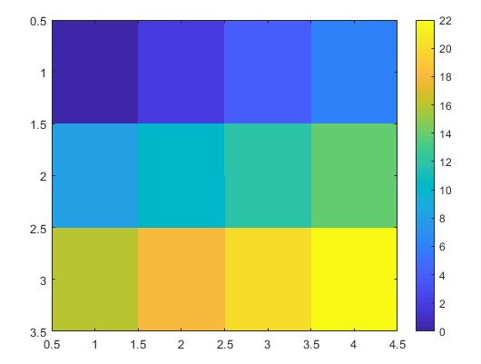

Post by jfrtx » Fri May 07, 2021 2:01 pm
The figure above is not from TeeChart, it was generated from Matlab. I was using it as an example for a continuous legend bar. The post was to ask for Steema to add a HeatMap series that has the following signature
double Nx = 101;
double Ny = 201
double[] x = new double[Nx];
double[] y = new double[Ny];
double[,] data = new double[Ny,Nx];
//where x and y are uniformly spaced data.
HeatMap(double[] x, double[] y, double[,] data);
The HeatMap would be displayed with the legend as shown in the figure.
Sorry for the confusion, Does TeeChart have another series that already does this?
Re: WPF ColorGrid DataBinding
Post by Christopher » Fri May 07, 2021 2:20 pm
Christopher wrote:
Fri May 07, 2021 9:36 am
No. As I say, I've add a feature request for a Heat Map series into our issue tracker with id=2422.
