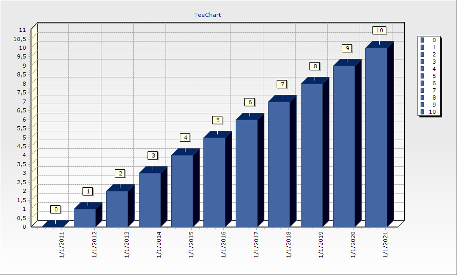

With you code, and setting the Increment to "OneYerar" I get this:
And after adding the following line:
_testChart.Axes.Bottom.Labels.Style = Steema.TeeChart.AxisLabelStyle.PointValue;
I get this:
