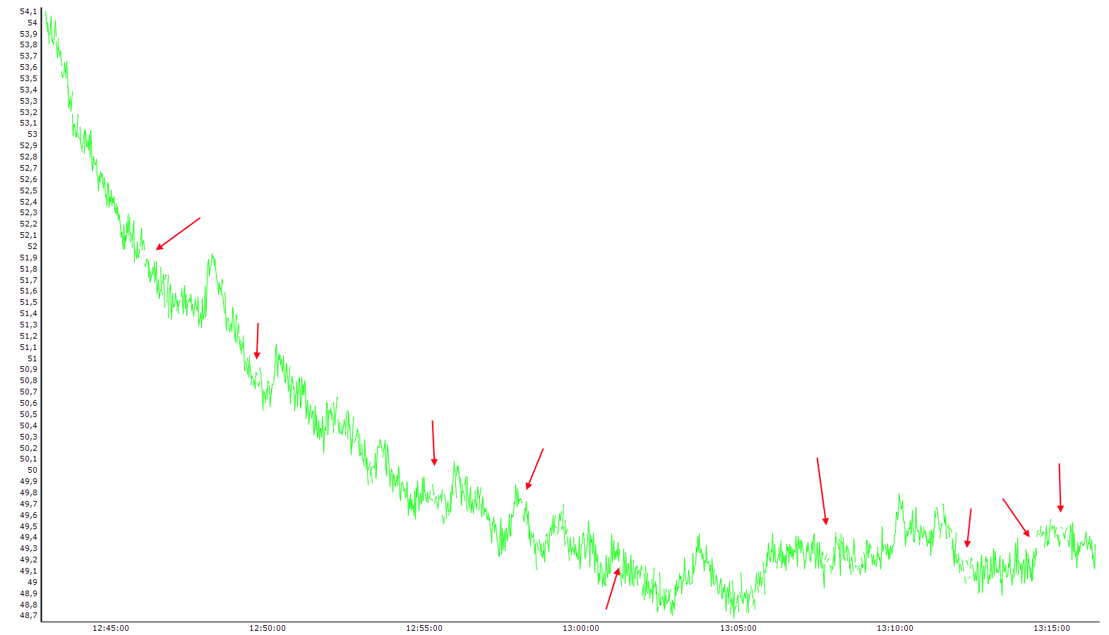

I have a graph, containing a single FastLine series. All the points should be connected, but in the graph, it appears to have blank segments.

And imported it into Excel, to see if there really is any null values in the series - but I have not found any.
The series data, with X/Y-plot can be found here: http://www.bendtsen.net/export.xls
Any advise on how to resolve this?

I've saved your xls as csv and imported it to a chart and I couldn't see any gap. Here is the code I used:
            InitializeChart();
        FastLine fast1;
            chartController1.Chart = tChart1;
            fast1 = new FastLine(tChart1.Chart);
            TextSource textsource1 = new TextSource("H:\\yeray\\examples\\Soren\\test.csv");
            textsource1.DecimalSeparator = ',';
            textsource1.Separator = ';';
            fast1.DataSource = textsource1;
            textsource1.Fields.Add(0, "X");
            textsource1.Fields.Add(1, "Y");
            fast1.CheckDataSource();
Could you please attach here a simple example project we can run as-is here to reproduce the problem here?
