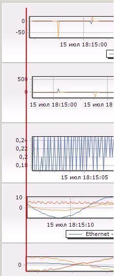

Good day, could you help me. I need to put in line several 2-D charts so that origins of charts will be in line. How can I do it?
see screenshot in attach

Hi starnov,
This happens because the chart is aligned automatically depending on the maximum label width of the chart. So to align different charts, you could find the max label width for all the charts and assign it to them:
            int maxLabelWidth = Math.Max(tChart1.Axes.Left.MaxLabelsWidth(), tChart2.Axes.Left.MaxLabelsWidth());
            maxLabelWidth = Math.Max(maxLabelWidth, tChart3.Axes.Left.MaxLabelsWidth());
            tChart1.Axes.Left.Labels.CustomSize = maxLabelWidth;
            tChart2.Axes.Left.Labels.CustomSize = maxLabelWidth;
            tChart3.Axes.Left.Labels.CustomSize = maxLabelWidth;

thank you very much
