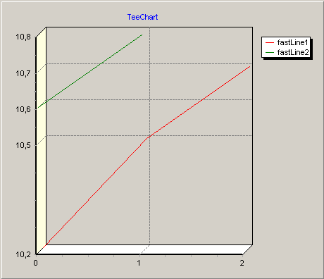

Re: Axis labels for multiple series
Post by Narcís » Thu Jul 23, 2009 3:28 pm
Hi Sachin,
Code below works fine for me here using TeeChart for .NET v2. It produce this chart:
Is that what you expect? Can you please try running the code exactly as I did? If this doesn't help, can you please attach a simple example project we can run "as-is" to reproduce the problem here and give us more information about what you'd exactly like to get?
