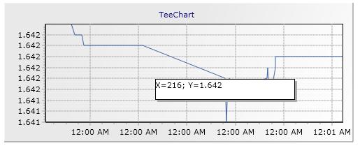

I am plotting datetime(time of bid) = x axis , against bid price in Y axis .
when the user moves the cursor i want to show the value of x,y in a annotation that follows the cursor , i managed to get the annotation to follow the cursor as seen in the attached jpg . but am not able to see the correct value of date X axis in annotation , it shows up as double instead of date . is there some calculate function to calc the date from that double value .

Hi Priya,
Yes, you can use FromOADate method:
			DateTime dt = DateTime.FromOADate(x);

Thanks Narcis , works fine .
